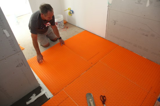

Heat in the Main Bathroom

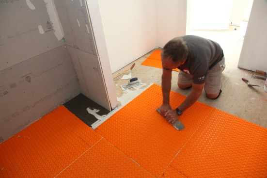

The clients asked for a heated floor in the main bathroom as well as in the shower, so I continued the heat membrane from the shower into the bathroom. The second course of membrane bridged the shower entrance into the main room.
As with the other areas, going over the membrane with a wooden float is very important. I continued installing the Ditra Heat membrane throughout the rest of the bathroom.
