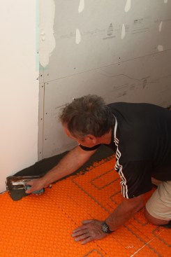

I spread thinset on the shower floor and up the first adjacent shower wall about 6 inches. Because there was no shower threshold, I extended the membrane well into the main bathroom area.
Again I applied a strip that bridged the seam between the wall and floor, and I went over the membrane with a taping knife to fully press the membrane into the thinset.
