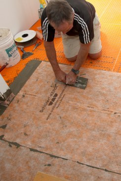

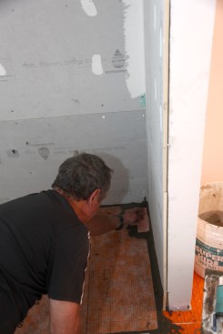

Working my way across the shower floor, I pieced in the membrane over to the partition on the other side of the shower. Again I installed a strip along the seam between the floor and the wall and used a manufactured inside corner for the corner of the shower.

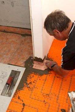

At the end of the partition I wrapped the bottom of the wall with two factory-made outside corners.
I then continued the waterproofing membrane a safe distance onto the floor of the main bathroom.
