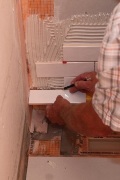

At the corners, the crew member marks the width of the tile he needs to complete the course.

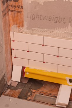

He leaves plenty of extra space in the corner and installs the cut tiles to complete the courses. He uses a scrap tile to support the end tiles of the courses.

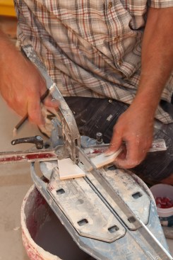

A score and snap cutter makes quick work of all straight cuts. Here, he cuts the angled tile he needs where the courses meet the slanted face of the shower seat.
