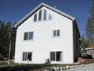

I recently retired after 30 years as a residential contractor. My wife and I now live in a new home I built in Colorado. It’s high in the mountains (elevation: 10,000 feet; heating degree days: 8,500) and has 2,000 square feet of conditioned space heated by a radiant-floor heating system.
The author’s Colorado home has 2,000 square feet of conditioned space. His combined average costs for heat and hot water are only $20 per month, a figure he credits to tight construction, programmed thermostats, and the efficiency of his tankless water heater.
While most radiant systems get their hot water from either a tank-type water heater or a cast-iron boiler, my home’s heat and domestic hot water (DHW) are both provided by a single Rinnai tankless — or “on demand” — water heater. The Rinnai uses considerably less energy than a tank-type heater and costs less to install than a boiler with a heat exchanger.
Tankless water heaters are a proven technology with a track record of many years for heating DHW (see “Installing On-Demand Water Heaters,” 2/06). But since few contractors have experience using them for radiant heat, information about reliable system design can be hard to find. In my case, perfecting a system took some trial and error.
I consider the effort worthwhile: During the two years I’ve had the system, heat and hot-water costs for two people have averaged less than $20 per month.
It’s important to note, though, that my house is super-insulated (R-35 walls, R-50 to R-60 in the roof) and takes advantage of excellent solar exposure. If the sun is out, which it often is in this area, we don’t need heat at all during the day. We also supplement our heating needs in the evening with a wood stove, which we enjoy for both comfort and ambience.
Finally, we use a programmed thermostat that limits the temperature to 62°F in the middle of the day and at night, and 70°F from 6 to 8 a.m. and 6 to 10 p.m.
