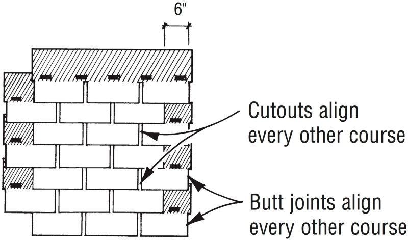

The straight-up method of laying shingles offsets alternating courses 6 in. from a vertical line up the roof (half a tab width for metric shingles). The alignment of butt joints and cutouts in every other course, however, can cause premature weathering of surface granules.
