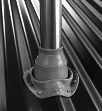

Plumbing vents and furnace flues. Round penetrations of almost any size are easily flashed with special rubber boot jacks that have a moldable aluminum compression ring, such as ITW Buildex’s Dektite and Aztec Washer’s Masterflash. The ring can be formed on site to custom-fit almost any panel rib profile (Figure 3 below).
Figure 3. To seal round penetrations, use a special rubber boot jack with a moldable aluminum compression ring, like this one from ITW Buildex. The ring can be formed to fit almost any panel rib profile.
These boot jacks are available in various sizes and colors, and some are made to withstand high temperatures. Most boot jacks slip over the top of the stack, but some versions can be wrapped around the pipes. This is especially useful for sealing an electric service mast, for example, when you can’t easily disconnect the power.
