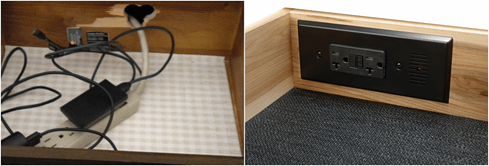

We have seen a lot of DIY/Post Inspection in-drawer outlet solutions that range from decent to the truly ugly and unsafe. Here’s my a photo of my favorite DIY/Post Inspection vs Docking Drawer in-drawer outlet solutions.
We felt there was some additional risk by putting things in drawers so in our products we designed in some innovative safety features. The Style Drawer family of in-drawer power outlets is designed for blow dryers, curling irons, and other devices that require a 20A GFCI outlet. Our powering outlets incorporate a UL Listed, American made thermostat safety feature which turns off power to the outlet when the temperature around the outlet reaches 120 degrees F. If someone accidentally leaves a blow dryer turned on or if it malfunctions the thermostat will shut off the power soon after the drawer starts getting warm and well before anything catches fire. We recently had a cabinet customer tell us a story about their clients DIY in-drawer outlet. The client, going through her normal daily routine, didn’t suspect anything was wrong when she put all of her items away in the bathroom drawer and pushed it closed. Unfortunately, the packed daily-use items inside the drawer combined with the drawer closing turned on the homeowner’s hairdryer. The excessive heat, trapped inside the drawer, slowly heated up an aerosol can filled with hairspray. Eventually, the can was unable to take the high temperatures and it exploded. Thankfully, the homeowner was out of the house and safe, but our product would have prevented this accident from occurring. The cabinet was not so lucky and was severely damaged. (Read more about it here).
