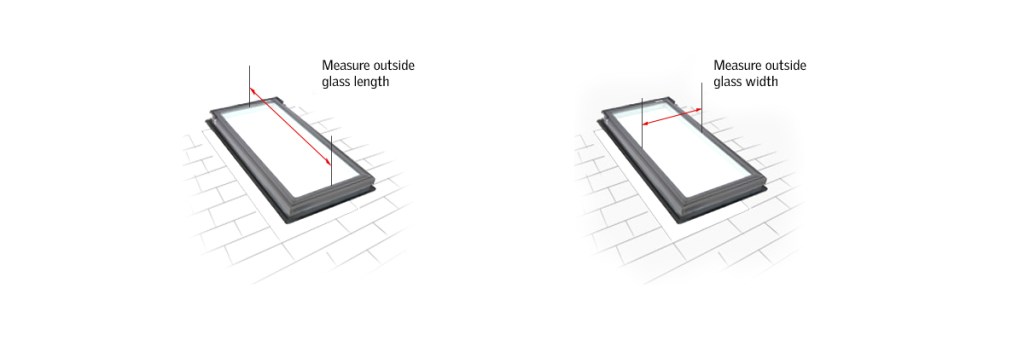

Measuring to replace an old VELUX deck-mounted skylight
Having the product ID tag information in hand when you call VELUX customer service, will help the customer service agent find the right replacement skylight. Even with the ID tag information, it’s still important to measure the old VELUX skylight to ensure you order the replacement size that fits best. For deck-mounted models, measure the exterior glass pane length and width from the inside edge of the cladding.
The newest VELUX models have a slightly different drywall groove, so the drywall panel at the top of the skylight may need to be trimmed down for the new skylight to fit. If there’s a gap between the drywall and the skylight, use door casing molding or crown molding to cover it. For small gaps, use painter’s caulk to fill in the gap.

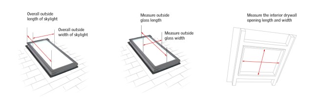

Measuring to replace a non-VELUX deck-mounted skylight
For non-VELUX deck-mounted skylights, measure the drywall opening length and width on the inside of the house, the length and width of the exterior glass inside the cladding and the overall size of the skylight (inclusive of cladding).

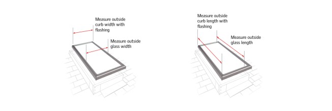

Measuring to replace VELUX or non-VELUX curb-mounted skylights
For curb-mounted models that are VELUX or other brands, measure:
  • the length and width of the outside curb, including the curb and any roofing membrane material, and
  • the outside glass and width from the inside edge of the skylight cladding.
