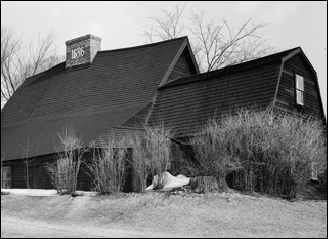

The gambrel roof style has a long history of enduring the elements. Some of the longest-standing wood-frame houses in America have gambrel roofs that date from the 1600s (see the photo below for the consummate example). I see a lot of gambrel roofs on Victorian-era houses in towns along the eastern seaboard (although the slightly different “mansard” variation is a more typical coastal style), and I also find gambrels on many shingle-style seaside summer homes built in the early part of this century.
Considered the oldest wood-framed house in North America, the John Fairbanks house in Dedham, Mass., dates to 1636. The two gambrel additions were completed later, probably around 1668.
