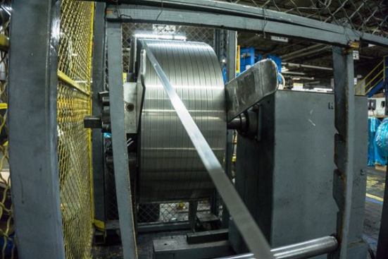

The sides or blade of a Speed Slot Hole Saw are made from bimeta…

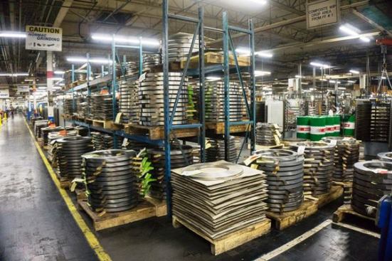

The sides or blade of a Speed Slot Hole Saw are made from bimetal material, a narrow strip of HSS (high-speed steel) edge-wire welded to a wider high carbon steel backer. The teeth are cut into the HSS, which is hard and resists wear better than high carbon steel. These are rolls of the carbon steel backing material before it’s attached to the HSS. It’s mind blowing to see how many towers of steel coil are stacked around the factory.

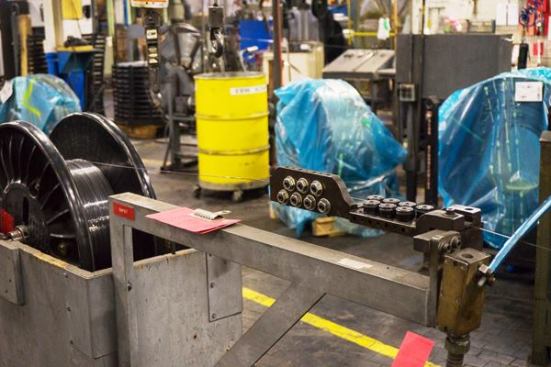

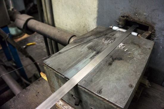

The edge-wire passes through straightening rollers before being …
The edge-wire passes through straightening rollers before being fed into an electron beam welding machine.

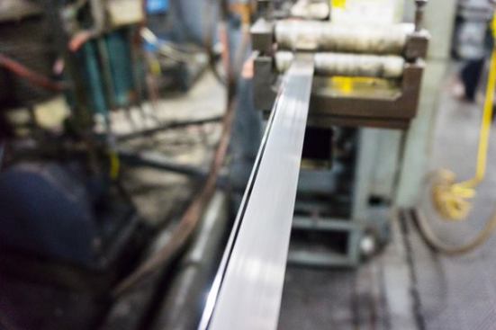

As they enter the welder the edge-wire and backer pass over a “box” containing an electromagnet. The magnet captures stray metal filings that could cause problems if they got inside the welder. Note the old-school toggle switch on the electromagnet (which looks like something I could build in my garage).
Brian Way

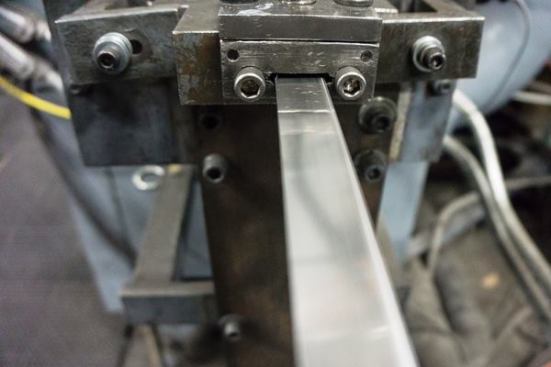

Here you can see the edge-wire and backer lined up before they e…
Here you can see the edge-wire and backer lined up before they enter the electron beam welding machine.

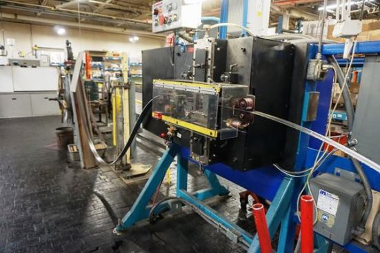

One of many electron beam welders in the facility, this particul…
One of many electron beam welders in the facility, this particular machine was designed in the 1960’s and has been in use ever since. Unlike regular welders, this machine uses an electron beam in excess of 7,000 degrees to fuse the two types of metal. Lenox has some newer equipment for this process, but I was not allowed to photograph it because they don’t want competitors to see it.

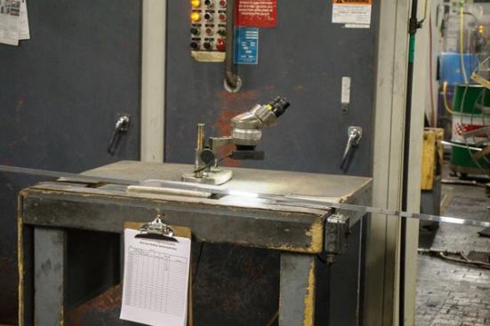

This old school microscope is used to spot check the quality of …
This old school microscope is used to spot check the quality of the weld.

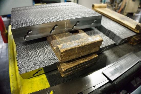

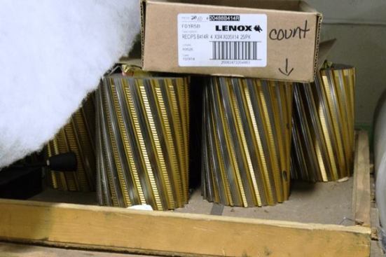

Cutter heads such as these are used to cut teeth in the band mat…
Cutter heads such as these are used to cut teeth in the band material for hole saw, recip saw, and band saw blades. You see these things all over the factory, as they are frequently changed out.
Brian Way

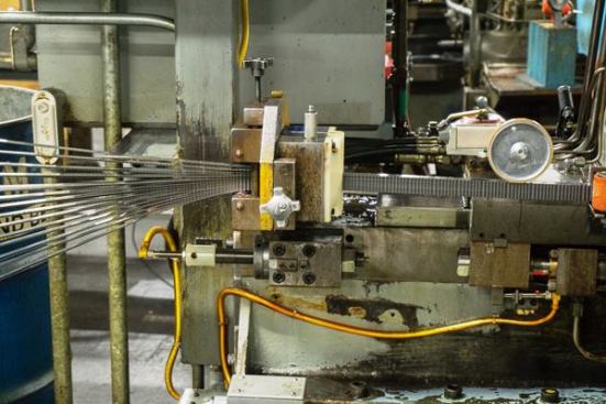

Multiple strips of bimetal material enter the machine on the lef…
Multiple strips of bimetal material enter the machine on the left, where they will be stacked tight before having teeth cut into them by the type of cutter head shown in the previous slide. They essentially gang-cut the things. Talk about fast!

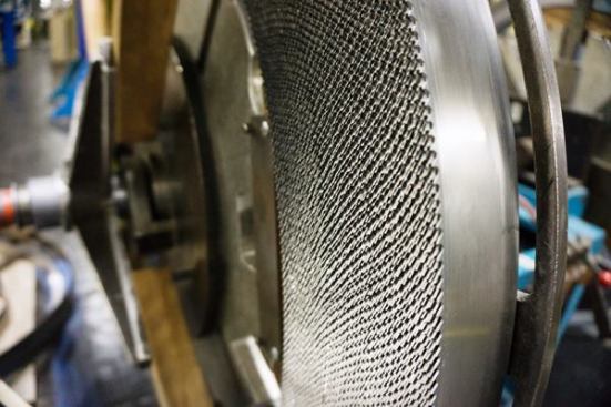

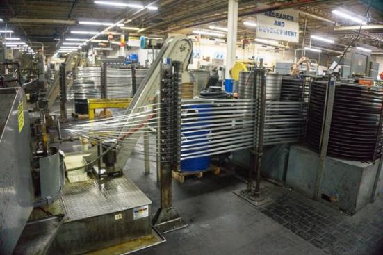

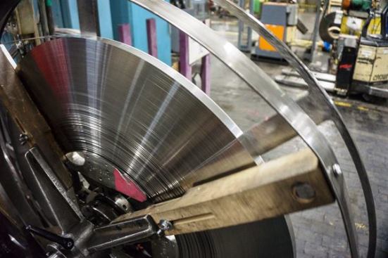

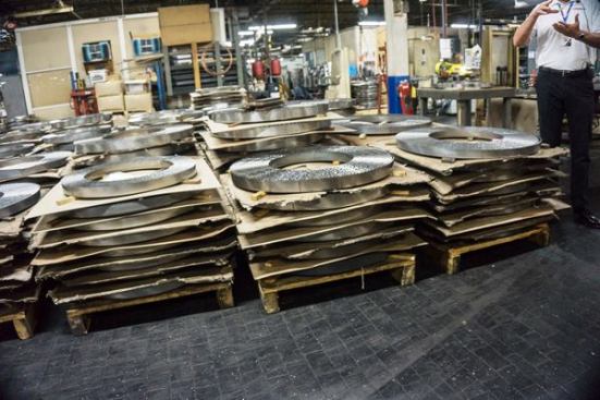

These coils of bimetal material have had teeth cut into them but…
These coils of bimetal material have had teeth cut into them but the teeth haven’t been set.
Brian Way
This coil of bi-metal material, has been placed on a reel and is…
This coil of bi-metal material, has been placed on a reel and is about to be fed into the machine that sets the teeth.

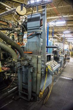

This is one of the machines Lenox uses to set teeth; it can set …
This is one of the machines Lenox uses to set teeth; it can set about 4 inches of teeth at a time. The strip goes in flat and comes out with the teeth set to the correct kerf width.

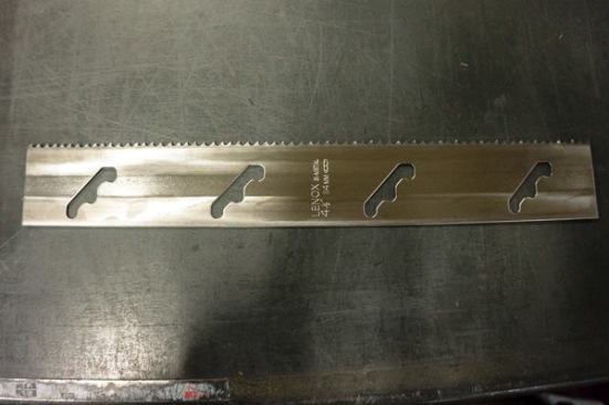

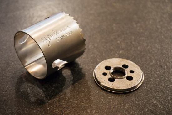

This stamped steel blade is ready to be formed into a hole saw.
Brian Way
Here’s what the pieces look like after the sides have been for…
Here’s what the pieces look like after the sides have been formed but before the forged end piece is welded on. I was not allowed to photograph the operation in which the blank is formed into a curve—which is too bad because it was my favorite part of the process. I agreed not to describe it in detail, but can say it involves more than heating and bending.

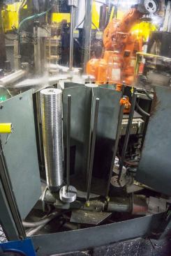

This “rotisserie” holds a stack of the forged steel plates (…
This “rotisserie” holds a stack of the forged steel plates (the flat end that connects to the arbor) that will be welded onto blades. They are stacked in this manner so a robotic arm can pick them up, position them, and hand them to the robot that does the welding.
Brian Way

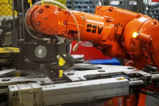

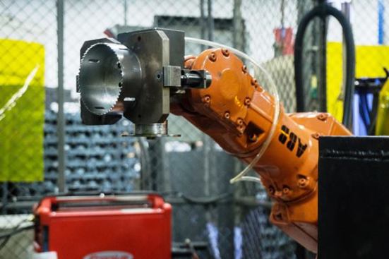

The robot grabs a plate & inserts it into the coiled blade. …
The robot grabs a plate & inserts it into the coiled blade. Another robot grabs the infant hole saw and brings it to the welding robot.The robot grabs a plate & inserts it into the coiled blade. Another robot grabs the infant hole saw and brings it to the welding robot.
Brian Way
The hole saw, with the forged rear plate has been picked up and …
The hole saw, with the forged rear plate has been picked up and is ready to be welded.

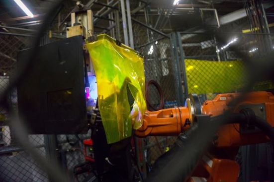

I would have loved to stick my camera in there and catch the wel…
I would have loved to stick my camera in there and catch the welding process—but peeking was not allowed. I am sure you can imagine what is taking place behind the curtain.

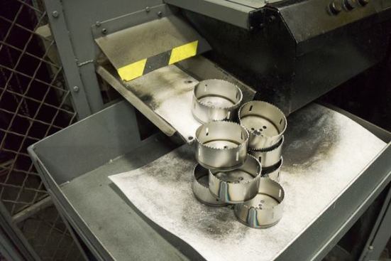

After the pieces are welded together, they are dropped into a tr…
After the pieces are welded together, they are dropped into a trough to cool.

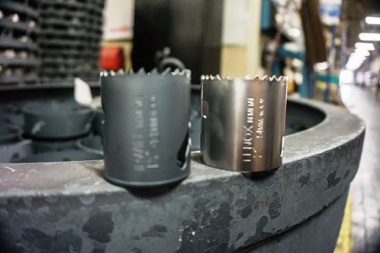

The next step is heat treating—which takes place in large vat-…
The next step is heat treating—which takes place in large vat-like furnaces where temperatures exceed 2,000 degrees. It takes many many hours to heat treat the pieces. The hole saws go in bright (like the piece on the right) and come out a dull grey color (like the one on the left).

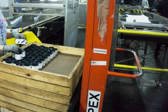

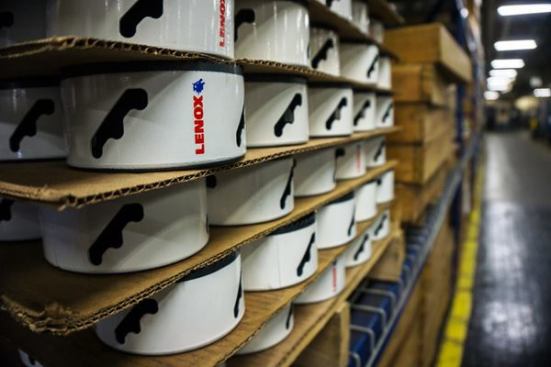

These finished hole saws have been stacked and are awaiting ship…
These finished hole saws have been stacked and are awaiting shipping. The shelves that contain them seem to go on for miles.

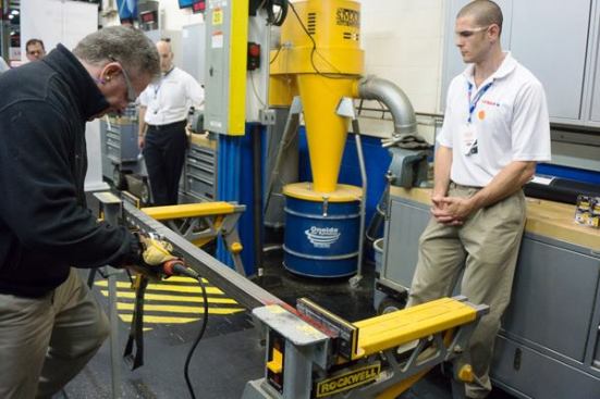

In this area of the plant hole saws and recip blades are tested …
In this area of the plant hole saws and recip blades are tested on a variety of materials—and against competitors’ products. The fellow in the dark jacket was on the tour with me and is using a hole saw to drill a piece of stainless steel.
Brian Way
The nearest saw is from Lenox and was able to drill twice as man…
The nearest saw is from Lenox and was able to drill twice as many hole Uni-Strut as a competitors saw, and it still has teeth left!
