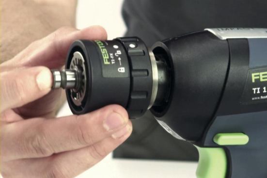

The 1/2-inch chuck attaches directly to the end of the hybrid dr…
The 1/2-inch chuck attaches directly to the end of the hybrid driver. It automatically disables the impact function so the tool can be used for regular drilling and driving.

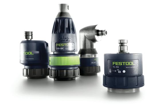

Non-impact-driving accessories include (left to right) an offset…
Non-impact-driving accessories include (left to right) an offset drive, a drywall screwdriver, a right-angle driver, and the adapter over which each must be installed.
Like the standard chuck, the adapter disables the impact functio…
Like the standard chuck, the adapter disables the impact function. The Centrotec chuck fits directly into it; other accessories can be installed over it.

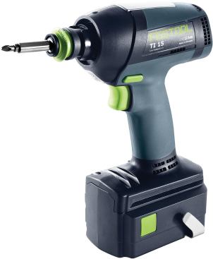

The Ti?15 is a 14.4-volt brushless impact driver that is also a drill/driver. The design is based on the idea that tradesmen should be able to use a single tool for most drilling and driving applications.
Like most of Festool’s drill/drivers, the Ti?15 has a 1/4-inch drive socket that various heads can be connected to. The tool includes a 1/2-inch chuck for non-impact drilling and driving, and an adapter that accepts such optional attachments as a right-angle drive, an offset drive, and a drywall screwdriver head. (These heads are not designed for impact use, and the adapter disables the tool’s impact mechanism.)

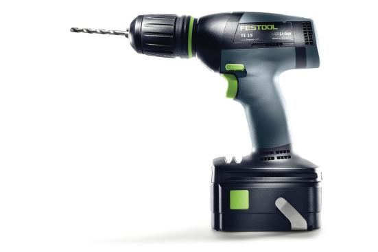

Drilling small pilot holes in wood presented no challenge, but since the Ti?15’s manual specified a maximum hole size (in wood) of only 1/2 inch, I wanted to see if it was really that light-duty of a drill. The tool had no trouble driving a self-feeding auger bit of up to 5/8 inch diameter through dry 2-by material, but a 3/4-inch bit stopped it cold every time. I’d begin to drill, and the electronic circuitry would cut power to the motor when the torque load exceeded the tool’s maximum limit. It never slowed or struggled — it simply stopped.
I was able to complete 1-inch holes with a nonfeeding spade bit, but the tool stalled at least once per hole. By way of comparison, my battered old 14.4-volt drill/driver powers right through — even in high gear.
The electronic clutch action of the 16 speed settings stops the tool motor at a preset torque for each setting, but doesn’t make much of a difference in driving depth. I found it easiest to leave the dial set to high and use the trigger alone.
Unlike standard drill/drivers, this model has a single gear setting; it lacks a low gear for drilling bigger holes. For a tool of its size, it’s not particularly capable in drill mode.

Centrotec bit holder. Operating the tool in impact mode requires the use of the included Centrotec impact bit holder. Like standard Centrotec holders (which have thinner walls), this one takes proprietary Festool bits.
Most contractors don’t have a supply of Festool bits (nor do most contractor supply stores), so they have to use the included Centrotec-to-1/4-inch magnetic bit adapter. Only 1-inch-long bits are recommended for use in the adapter. This is a basic shortcoming; many people (myself included) don’t like using magnetic bit holders, especially for impact driving, because the long adapter flexes and absorbs a lot of the impact energy.
Drill chuck. Impact drivers lack the transmission and built-in motor brake of drill/drivers, so you cannot tighten the chuck of the Ti?15 in the usual way. You must run the motor or use two hands on the chuck to make the jaws close in on the bit. To get it tight, you must push the chuck into the motor housing until it engages with a locking gear that allows you to crank it down. This works, but is so different from normal it’s hard to get used to.
