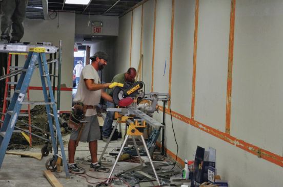

Steve Demetrick, a residential remodeling contractor in Wakefield, R.I., constantly moves his miter saws around jobsites and owns several DWX723 stands. He likes them, but notes some shortcomings: The stops aren’t accurate enough for finish work; the “universal” brackets don’t accept all saws without modification; and the material supports on top of the extensions will eventually connect loosely if you overtighten the securing knob. Demetrick also uses DeWalt’s DWX724 model, which is similar to but shorter than the DWX723.

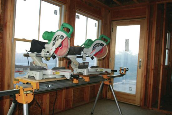

Some builders, including John Spier of Spier Construction, on Block Island, R.I., occasionally mount two saws on the sturdy main beam of the DeWalt stand so that they aren’t constantly flipping stock end-for-end or tilting the saw from side to side when cutting lots of compound miters. DeWalt makes this easy by offering extra mounting brackets (DW7231) as an accessory. Spier always bolts the quick-release mounts to a piece of plywood and then bolts the plywood to the saw, which eliminates compatibility issues and anchors the saw more firmly to the stand. He also bores a hole in the plywood, where he stores his blade wrench.
