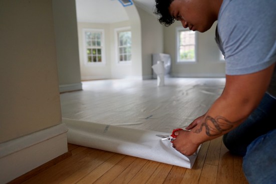

We use scissors frequently for site protection, specifically for cutting finish floor guard for hardwood floors, rosin paper, Ram Board, heavy-duty 4- and 6-mil plastic, and light painters’ plastic. We also use scissors for cutting rope like 550 paracord. We tested the Super Combo Scissors (VT-011) on all those materials.
Several features separate these scissors from most construction-grade scissors I have found at big box stores. The 4-in-1 multifunction tool has a flat blade for smooth cutting of cloth and paper and a lower, serrated blade to hold the material without slipping; a wire cutter close to the handle for copper or steel wire; and a built-in safety box opener for cartons.
One feature we had mixed feelings about was the serrated blade. On one hand, it cut through heavy rope and 550 paracord easily and excelled at any chopping activity. On the flip side, when using the scissors to slice or push through 6-mil plastic, we had to be aware of how open the blades were. Because of this, some of the guys found using the scissors awkward for setting dust barrier walls. I liked the heavy-duty plastic sheath that came with the scissors came; it would be even better if it had a belt clip.

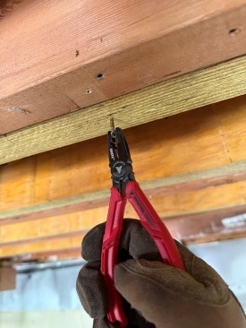

After having the Brute Screw Extractor Pliers (VT-002-6) in my bag for a number of weeks, I can say I like them. They’re smaller than lineman’s pliers and similar to needle-nose pliers in size and feel, but with a clipped nose. Among other stand-out features, the black oxide coating seems extremely durable, and the thermoplastic rubber grips have a slight give and feel more slip-resistant than those on other pliers I’ve used. For pliers of this size, they have aggressive teeth, which, according to Vampire Tools, can bite onto stripped fasteners. I had limited success when I tried this.
My final take is that both tools are a solid value, and I am confident they’ll perform as needed. I would struggle to find a better pair of scissors ($30) and pliers ($36) at these prices.
