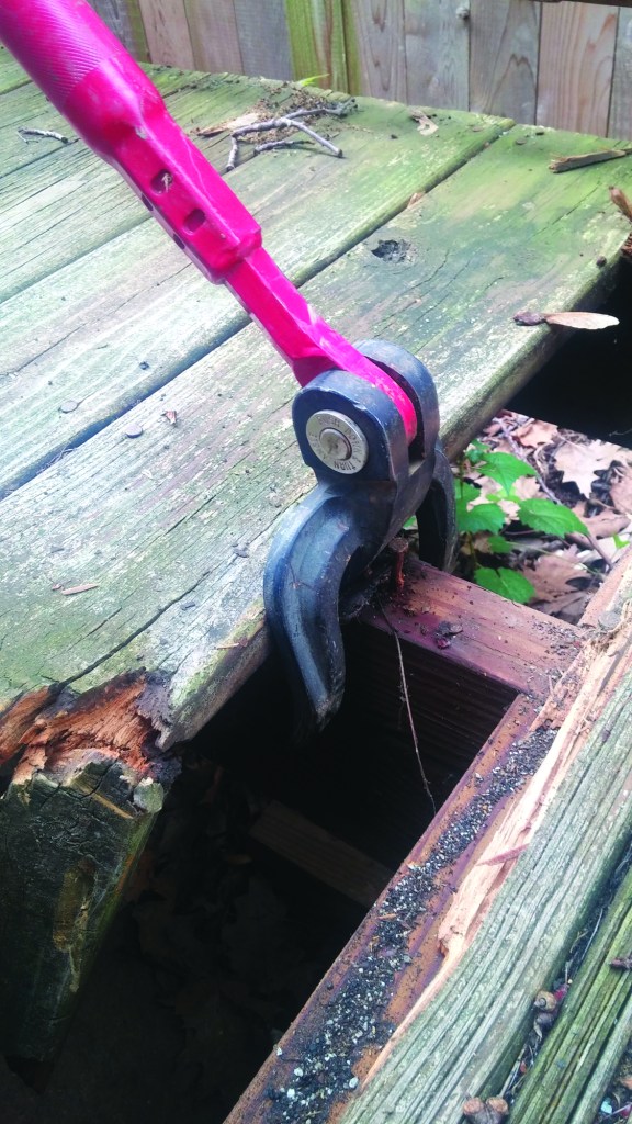

Crescent Bull Bar
Crescent Tool’s Bull Bar is heavier than a few of the other tools that we own, and it has an indexing head that rotates 180 degrees, allowing the user to select the best angle for maximum leverage and access. In the open position, the head can generate leverage to pop large planks from joists, while the closed position provides for shorter pulls and faster action when you’re working in confined spaces.
The gap between the double forks is wide enough to straddle a pair of 2-by joists, and at the center of the jaw is a built-in nail puller, which comes in handy for initially working over a deck before pulling up any boards.
The tool’s greatest drawback might be its shorter, 44-inch-long handle—but in tight spaces, that short handle is also a tremendous advantage, especially when coupled with the adjustable head.

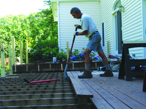

Gutster
The Gutster has been through several design incarnations since its initial release. The original was extremely durable; we’ve demoed hundreds of decks with our first Gutster, though it’s now beat-looking and bent. Then the manufacturer switched to an oval-tubed design, which wasn’t nearly as reliable. We had a couple of them, and the head welds cracked after one or two jobs. The manufacturer has since gone back to a 48-inch-long round handle, which seems to have fixed the problem.
This tool provides excellent leverage for prying apart framing and removing the first couple of deck boards. It fits over single or double joists and has two pointed “fangs” you can jam into cracks and joints to gain purchase. The tool is ergonomic but heavy enough to split a 5/4×6 cedar deck board in half if used in a downward stabbing motion. It also has nail-pulling slots—much like those on a roof shovel—that are useful for quickly de-nailing joists during resurfacing projects. Since the design of the tool requires that the user stand on the joists while prying up deck boards, we don’t like to use it for board removal—but we use it for everything else. Sometimes we even dig with it [Ed. note: Gutster inventor Wayne Yoson points out that he suggests that users remain standing on the decking rather than the joists, removing 4 or 5 courses of decking at a time before moving on to the next section of decking. Then, when about 4 to 5 feet from the house, remove 3 or 4 rows of decking, then slide them over to serve as a temporary scaffold on top of the joists as you turn around and remove the remainder of the decking].

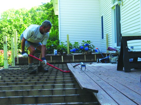

Duckbill Deck Wrecker
To remove deck boards, we rely mainly on the Duckbill Deck Wrecker. That’s all it’s designed to do—and without a doubt, it’s one of the fastest ways to get this job done. The long handle provides plenty of prying power, and the head spans the joists and presses up from below in such a way that the user can stand on the deck while levering off boards with amazing speed.
The tool works on boards that are nailed or screwed. Although I’ve never timed it, I would guess that a two-man crew can de-board a 250-square-foot nailed-down deck in about 15 minutes. The boards come off so quickly that a helper can stay busy clearing and stacking deck boards as they’re removed.
We like that we can reverse the head by pulling a pin and flipping it around, because where there isn’t enough room for the handle to be levered, we can still get into tight spaces. It’s a highly specialized tool that is worth every penny.

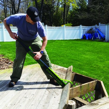

GreenTek Demo-dek
Another quick deck removal tool is the Demo-Dek, a hybrid design consisting of an alloy steel 5140 jaw and an ultra-durable laminated bamboo handle. While other deck-board removal tools use the underlying deck joist for prying leverage, the Demo-Dek uses the deck board itself. I was skeptical when I first heard the claims of inventor Ben Weinreich, who is a licensed contractor in Maryland, but putting it into action made me a believer—quickly.
The U-shaped jaw of the standard Demo-Dek, which is the one we tested, is fixed and can accommodate standard 5/4 and 2-by decking. The Demo-Dek can be used at any point on the decking—we didn’t have to locate the head of the tool over a joist as with most other decking removal tools we’ve tried. This feature makes an even bigger difference on decks with doubled joists or wider framing members that can hamper tools—to the point of making them useless—that rely on a joist for leverage.
The Demo-Dek generates a large amount of prying torque. We used the tool on both nailed and screwed pressure-treated 5/4 and 2-by decking, and it didn’t slow down a bit. To prevent soft or rotted boards from splitting lengthwise between the fasteners, we found that it was cleaner to work down the length of the board and pry incrementally, even though the tool provided so much torque that we were tempted to break the board free in one big pull. We used this approach more often on 5/4 boards than on 2-bys.
In addition to appreciating the power the Demo-Dek provides, we liked the way the tool can capture a deck board in its jaw. This allowed us to hold onto a removed board and move it around, on or off the deck. Other tools break the board free, but then the user has to bend down to grab the board or kick it to move it out of the way. Being able to swing the removed board to wherever it made sense and flick it out of the jaw without missing a beat was a huge time-saver. And for any fasteners left behind, the Demo-Dek has a built-in nail puller.

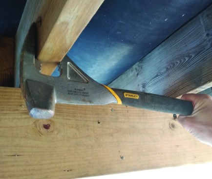

Joist Tamer
I frame decks with southern yellow pine, which tends to go a little wild at times, especially when left sitting in an unrestrained pile. Straightening out twisted joists during installation used to be a pain until I happened upon this specialty pry bar.
Stanley FuBar. The F-shaped head of Stanley’s multipurpose 30-inch Fatmax FuBar utility bar grips around joists, and an offset design gives you a little more leverage. The back of the “F” has a striking face for pounding, and the handle end is a pry bar with nail-pulling slots—making it a good all-around tool for demolition and construction. Stanley manufactures shorter versions of this tool, and other manufacturers offer similar variations that can be used the same way.
