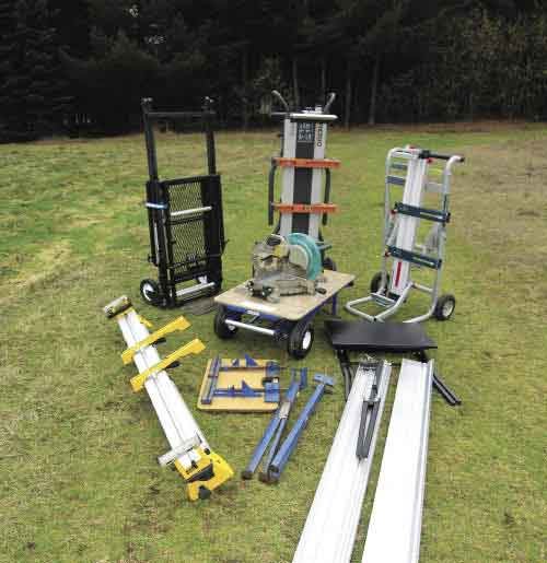

What We Considered
We focused on the following five criteria:
Strength. Because we commonly toss 60-pound 4×8 pressure-treated beams onto a miter-saw stand, it had better be able to handle heavy materials.
Mobility. A stand that’s easy to relocate is a must. After as few as three days — and rarely after more than three weeks — deck builders move to greener pastures. Also, leaving a stand in a backyard overnight isn’t always advisable, which means daily set up and take down can be necessary regardless of how long we’re in one location. The less time that takes, the better.
Ergonomics. The right height for a saw is different for each person, so being able to adjust the height of the stand is a plus.
Value. What do you get for your money?
Storage. Space in the truck can be at a premium. Some stands fit behind the seat, but others occupy a significant portion of the bed.

There is no initial assembly of the TWC-35, our personal first choice for daily use. It consists of two folding legs that clamp to the bottom of any length of two-by material, which acts as a center beam. A 16-inch-by-24-inch saw platform clamps to the top of the two-by; two 10-inch support rollers also clamp to the two-by and are easily adjusted to the height of the saw.
The TWC-35 is 35 inches tall, but the stand also comes in a 27-inch version. I prefer the taller one (I’m 6 feet 3 inches tall). Because the center beam can be any width of two-by, the height of the stand can be adjusted by using, say, a 2×10 instead of a 2×8.
The length of the two-by determines the length of the stand, so that means this stand can be up to 20 feet long and support even the heaviest lumber pieces. When the center beam is a 20-footer, six rollers work the best, three for each side of the saw. Combining two TWC-35s allows for two miter saws in one space, which can save time for deck builders with crews.
Combining two TWC-35 stands creates a long and sturdy work area capable of supporting two saws for busy crews.
It does take a few steps to set up. Spreading the legs apart clamps them securely to the two-by; four little dog ears inside the clamp jaws embed themselves in the wood to create an extremely strong grip. Pushing the locking bar with your foot locks the legs into place. Ball-bearing rollers adjust to the proper height and allow you to tweak the material that last 1/8 inch to dial in an accurate cut. The saw table is a little small for big sliding compound miter saws, but it’s big enough for a 12-inch miter saw.
The three parts of the TWC-35 stand fit behind the seat of most pickups.
A C-clamp secures the saw to the table. It can be easier to move the saw than the workpiece, so instead of bolting the saw down, we use one clamp that we tighten just enough to allow the saw to pivot to make a square cut.
