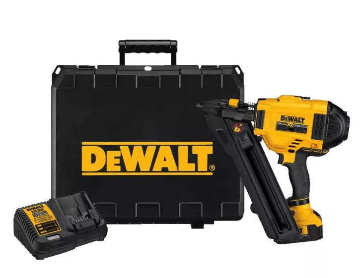

The fastest way to install metal connectors is with a pneumatic nailer, but DeWalt’s new 20-volt DCN693 metal connector nailer is the next best thing, especially if you don’t want to be tethered to a hose and compressor. It’s faster than using an impact driver to install metal connector screws, and of course way faster than nailing by hand. We tried it out recently while building a 53-foot-long deck.

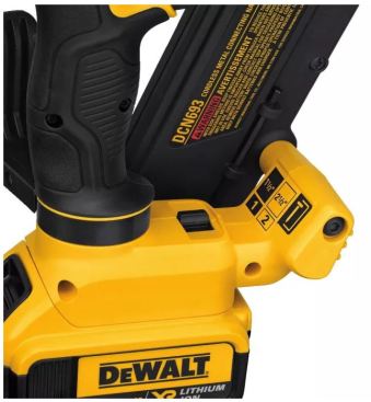

The nailer has a brushless motor powered by DeWalt’s 20V MAX lithium-ion battery platform, and takes standard 30- to 35-degree paper collated 1 ½-in. or 2 ½-in. connector nails. You change nail sizes by flipping a switch located just below the rear of the handgrip on the back of the battery mount. There’s a large easy-to-twist thumbwheel at the front of the tool that quickly adjusts the depth of drive, and the nailer also has a rafter hook.
DeWalt
The nailer can use either 1 1/2-inch or 2 1/2-inch fasteners. The selector switch is located on the base of the tool.

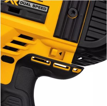

Sequential mode is indicated by a single arrow on the selector switch.
Operation. There are two operation modes—sequential fire and rapid cycle. A slide switch to toggle between firing modes is located on the magazine side of the tool just below the cap; one arrow for sequential, two arrows for rapid cycle. When you position the probe-tip into a connector hole in sequential mode, the motor automatically winds up and is ready to fire. When you pull the trigger, the tool sinks the nail, and then the motor winds down when you remove the tool from the connector.
In rapid cycle mode, the motor continues to spin for a few seconds after firing off a nail so you have time to place the tip for another shot without waiting for the motor to wind up again. In rapid cycle you can fire off nails as fast as you can re-position the probe tip into connector holes.

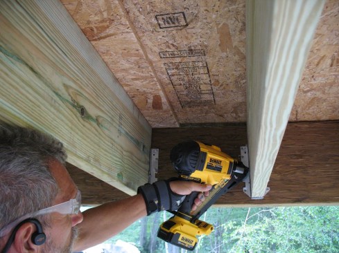

Bruce Guertin is using the DeWalt 20V nailer to install joist hangers in a dense PT PSL beam.
We didn’t test to find out the maximum number of nails a charged battery would drive in either mode, but on this deck, we were able to nail off 48 2×6 joist hangers and 18 2×12 joist hangers in sequential mode, and the battery still had plenty of life left in it. The nailer had no trouble sinking nails flush with the hangers in the dense PSL rim joists on the outside, and did equally well on the SYP ledger after dialing back the drive depth.

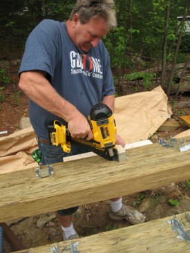

Ergonomics. As with any battery-operated tool, the trade-off with going hoseless is weight. While the specs say that the DeWalt nailer weighs 8 pounds, we found that it came in at just over 9 pounds with the battery and no nails. In comparison, the nailer is almost the size and weight of the original metal connector nailer, Paslode’s F250S Positive Placement MCN. It’s bulkier than my Bostitch StrapShot 150-MCN (though that tool only drives only 1 1/2-in. nails), but smaller than my Bostitch F33PT switchable probe-tip framing/MCN tool (though roughly the same weight).
In practice, we found that it fit fine between 16-in.-o.c. joists when shooting the shear/diagonal nails. If you’re working with 12-in. o.c. framing, though, I’m not sure if it will be as easy to position the nailer.
Mike Guertin
While the nailer weighs close to 9 pounds, it fits easily between 16-in. o.c. joists.
