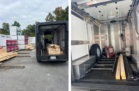

For the building trades, the two critical features of the BrightDrop 400 van are its payload capacity of 3,480 pounds and excellent maneuverability. Cargo-area height with the door open measures 76 inches; floor length is 117.5 inches; and the width between the wheel wells is 54.71 inches, 83.68 inches wall to wall. There are ample tie-downs and rails for mounting custom toolboxes and shelving.
At 3,480 pounds, the payload capacity of the AWD BrightDrop 400 exceeds the 3,325-pound capacity of the 2025 Ford F-150—the leader among 2025 Class 2A pickups. (Compare this with the payload capacities of other full-size, Class 2A pickups: 1,750 to 2,280 pounds for the Chevrolet Silverado and 2,370 pounds for the Ram 1500 with a Pentastar V6. However, with a gross vehicle weight rating of 9,900 pounds, the BrightDrop 400 fits a 2B classification. That puts it in company with the Ram 2500 and Ford F-250, which have payload capacities above 4,200 pounds.)
The most we loaded on the BrightDrop was 50 2x6x8-foot studs with another 25 2x4x8-foot studs stacked on top—about 1,000 pounds in all. Not too surprisingly, we noticed zero change in the height of the suspension with this load. We certainly had a lot more room in the cargo area, and if this were our regular work van, we would probably be carrying at least 1,500 pounds of tools and hardware in addition to any materials, but even that would leave us a healthy margin to load it up more. The added weight would use up more battery charge, just as an ICE truck will use more gas or diesel when loaded.

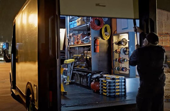

GM Envolve
A significant benefit of a step van for the building trades is a cargo area that can be customized to organize and transport tools and equipment while leaving room to haul materials. Whalen’s week-long test didn’t provide the opportunity to realize this, but this photo from GM suggests the possibilities.

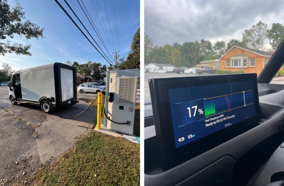

By far, the biggest adjustment for me was learning about the battery and charging it. Note that our tests weren’t perfect: We didn’t have another EV for comparison, and we couldn’t fully load the truck with tools, which would have reduced the driving range on a charged battery. Over the week, we only had to charge the van twice. This was straightforward: Plugging in the charge cord is not much different from filling up at a gas pump, except for a green indicator light near the charging port that turns on when charging is complete. To stop charging before that happens, I simply had to press “stop” on the charging station or on the vehicle’s dashboard screen.
If we owned an EV, we would install a charger at our shop, so we could charge it overnight and wouldn’t have to waste production hours charging it during the day. With the max-range battery on the model we tested, it took about an hour to add 160 miles of range at a DC fast-charging station. (Reportedly, it takes about 10 hours with a Level 2 charger for a full charge, and about two hours with a DC fast charger.)
Charging at a DC fast charger is not much different from filling up at a gas station, except it takes longer. To maintain battery health, GM sets the maximum charge to 80%; it also recommends charging the battery when its capacity decreases to about 20%.
You’ll get better driving range if you don’t stomp on the drive pedal but instead accelerate gradually and evenly. It’s also better for battery health to avoid frequent DC fast charges. And like with phones or other devices powered by a lithium-ion battery, it’s best to charge to about 80%. (Cordless tool chargers do not allow this; power tool companies are in the business of selling us batteries.) The default on the BrightDrop limits the charge to 80% (160-mile range), though you can override this to get 100% charge if you need the full range (272 miles) for a longer trip. For optimal battery health, GM recommends keeping the vehicle plugged in when parked, especially in extreme temperatures. This allows the van to use an external power source to regulate the battery’s temperature.

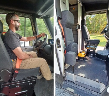

Instead of the van’s six-way adjustable bucket seat for the driver plus the small, not-too-comfortable jump seat that folds down off the back of the cabin wall, we would prefer a bench seat that could accommodate a couple of carpenters, even though that configuration would block the door into the cargo area from the cabin. The trade-off would make sense for our profession, especially if the bench seat could be designed to fold out of the way to allow occasional access to the cargo area (and we’d want to be able to slide long lumber under the seat). The lack of a bench-seat option was the one aspect of the BrightDrop that we didn’t like and that would motivate us to look at other vans.
The driver’s six-way-adjustable bucket seat (above left) is comfortable, but the fold-away jump seat (above right, in foreground) is not. For the trades, a bench seat that can seat three would be more functional.
