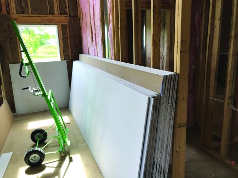

In addition to carrying various types of drywall, supply yards carry a variety of lengths, but the sizes available can depend on what region of the country you live and work in. Where I live in upstate New York, I can easily get 8-, 9-, 10-, 12-, 14-, and 16-foot lengths in 48-inch widths, and I can even get 12-footers that are 54 inches wide.

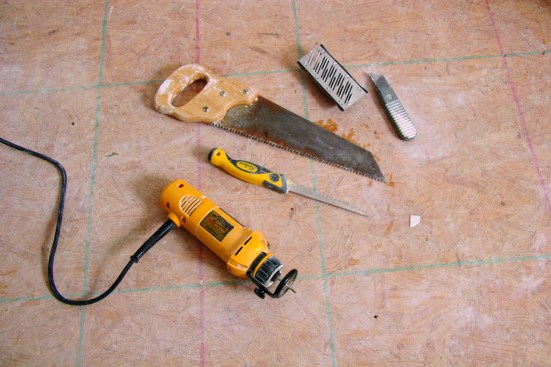

Drywall cutting tools. Most drywall cutting is done with the “score-and-snap” method, using a utility knife for the scoring, but a drywall utility saw is necessary for making cuts where you need to notch the material or make more than one cut in a sheet to remove a section. A drywall router can also be handy for cutting out electrical boxes, but that tool does come with a learning curve.

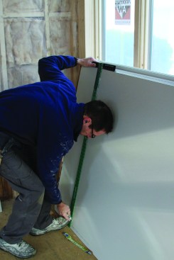

Crosscuts. For making cuts across a sheet using the “score-and-snap” method, a drywall T-square is a must. When setting the blade of a T-square at your measurement, get in the habit of holding the bottom of the blade with your foot to keep it from moving as you score the sheet with your utility knife.
To cut a sheet of drywall to length, set the T-square at the measurement and score along it with a sharp utility knife.
Hold the square in place with one foot. Snap the piece back and cut through from the opposite side.
To cut a sheet to length, place the T-square on the measurement mark and score the paper face with a sharp utility knife. Then snap away from the side you scored and run the knife down the opposite side.

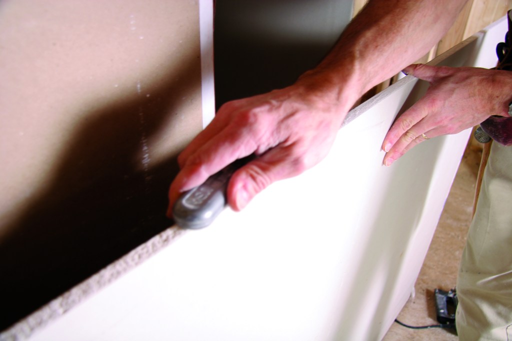

Score a rip by pulling the utility knife and the bottom of your measuring tape along the sheet.
Snap the sheet back and score from the other side to remove the rip.

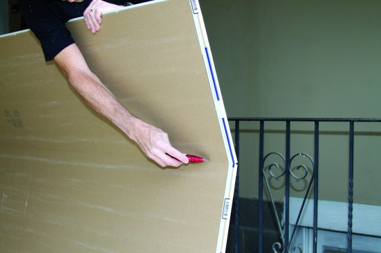

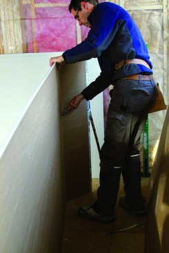

Rip cuts. For cuts along the length of a sheet (rip cuts), I use a tape measure and utility knife. I pinch the tape between my thumb and forefinger at the measurement I need to remove, and then let my finger ride along the top of the sheet while I score the sheet with a razor knife held against the hook of the tape. The trick here is keeping the tape perpendicular to the top edge for a straight score.
When I’ve scored the entire length, I snap away from the cut as with the end cut. But this time, gravity is working against you and wants to rip away the part you scored. Have another crew member help hold the sheet while you cut the score from the back. With practice, you can do this by yourself.
A drywall rasp can clean up a rough edge.
Don’t be overly concerned if the cut is not perfectly straight. Remember a tight fit is not necessary. For beginners, snapping a chalk line might be easier than trying to use the tape-measure-and-knife method. And you can always use a drywall rasp after the cut to clean up the edge if you need a better fit.

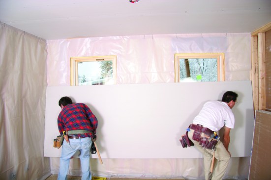

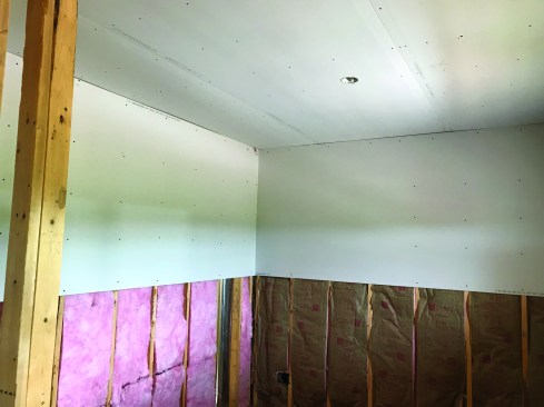

Top panel first. When hanging drywall, always put the ceiling panels in first. That way, the edges of the ceiling panels are supported by the wall panels. Here, we are focusing on walls, so let’s assume that the ceiling drywall is already in place. In residential construction, the walls are usually hung horizontally because there is less waste compared with a vertical installation.

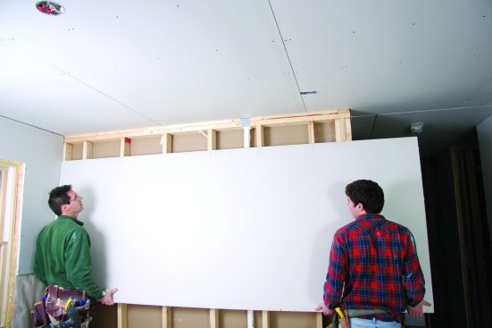

The top panel should always go in first. If necessary, cut the board to length. Next, set it on the floor directly below where it will be installed and mark the stud locations along the top edge. Lift it into place with a helper. Once the top edge is pushed up tight to the ceiling, drive a couple of fasteners at one end to tack the board in place. Then fasten the field, working toward the opposite end.
The main concern for the drywall finisher is a quality finish, and this starts with having to tape as few seams as possible. Starting with a full-width sheet means just a single horizontal seam on the walls for most rooms.

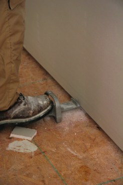

A drywall foot lift snugs the bottom sheet against the top sheet before fastening.
Bottom panel. After fastening the top sheet in place, cut the bottom one to length. With many of the houses I work on, I can use a full sheet on both the top and bottom and still have some leftover height to maneuver the sheet into place. If there isn’t enough room for a full-width sheet on the bottom, rip off enough to allow a 1-inch gap along the floor. Always put ripped edges along the floor and put the tapered factory edges along the seam.
To snug the bottom sheet against the top, use a drywall foot lift. A pry bar will also work but typically requires a scrap piece of drywall or wood as a fulcrum to give it enough lift.

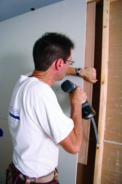

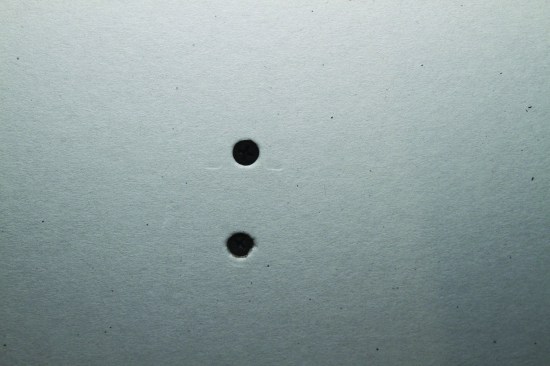

Fastener depth. The tip of a drywall screw gun is designed to drive fasteners to the proper depth. Don’t force it. The top of each screw should be about 1/32 inch below the panel surface. If the screw breaks the face paper, then it is too deep. If a screw is too deep, I drive an additional screw about 1/2 inch away.
To fasten walls, I drive screws every 16 inches along each stud 16 inches on-center. If there are intermediate studs closer together, I often skip them. I try to keep the bottom course of screws close to the floor so the baseboard will cover them, and close to window and door rough openings so that the casing will cover them.
The top screw is driven properly, but the bottom screw has broken the paper around the screw head.
