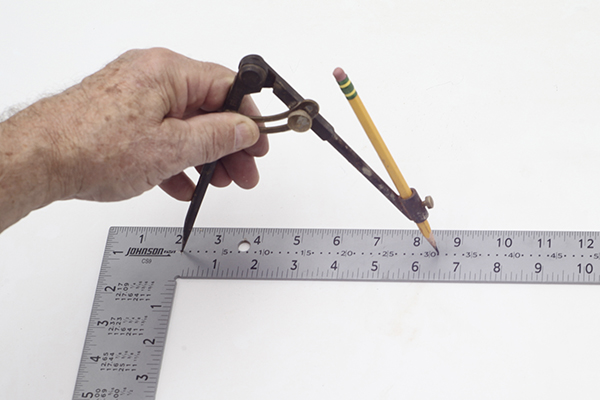

Math-free layout. To see how this works, let’s say you need to frame an octagonal rough opening that’s 31 inches wide for a 30‑inch octagonal window. Begin by framing a square opening that’s 31 inches by 31 inches. Now, find and mark the center of each side. From each center point, measure and mark in both directions a distance that’s equal to 31 increments on the octagon scale.
I like to use my divider for this task. I place one leg of the divider at the first line at the beginning of the scale and the other at the dot representing 31. I lock the divider at this setting, then use it to step out and mark in both directions from the center marks on the four sides of the window opening. These marks represent the eight corners of the 31-inch octagon. All that remains is to measure, cut, and install the four diagonal pieces.

To lay out a 31-inch-wide rough opening for an octagonal window, the legs of a divider have been set to the “31” increment on the octagon scale, which measures 6 7/16 inches.

The divider, of course, is not essential. You can use a tape measure, a ruler, or just a strip of wood to take and transfer the measurement. The measurement you need to step out from the center point, by the way, is a hair shy of 6 7/16 inches. And the length of each side—and also of the diagonal pieces—is double that, which is 12 7/8 inches.
