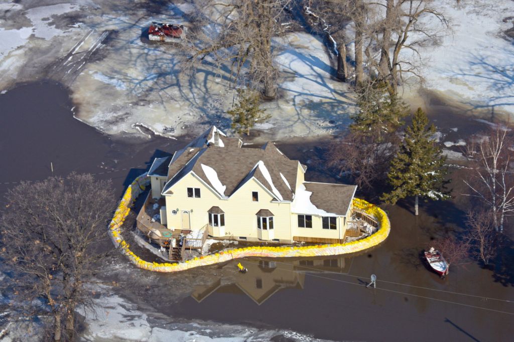

Sandbags supply emergency protection for a house in flooded farmland near the Red River in Hendrum, Minnesota, in March 2009.
Andrea Booher/FEMA

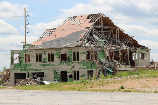

A family sheltered in the basement of this shattered building during the 2011 Joplin, Mo., tornado.
Ted Cushman

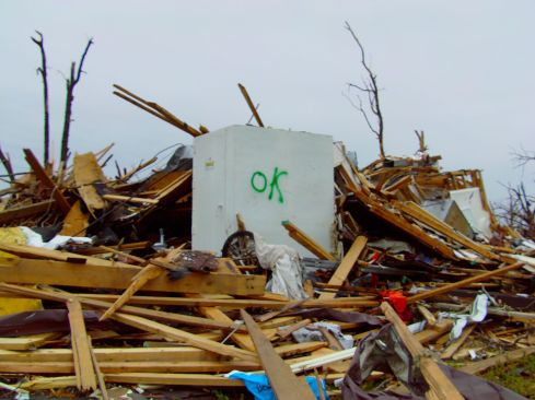

A Joplin resident survived the 2011 tornado by hiding in this Twister Safe steel storm shelter, as the building around it was reduced to splinters.
Twister Safe

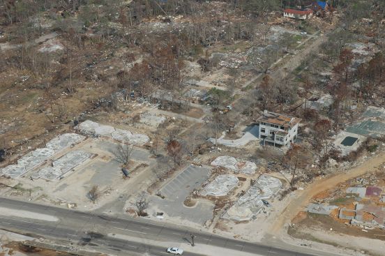

An elevated concrete home under construction is the only building left standing among "slabbed" conventional homes in this aerial photo taken after Hurricane Katrina, in Pass Christian, Miss.

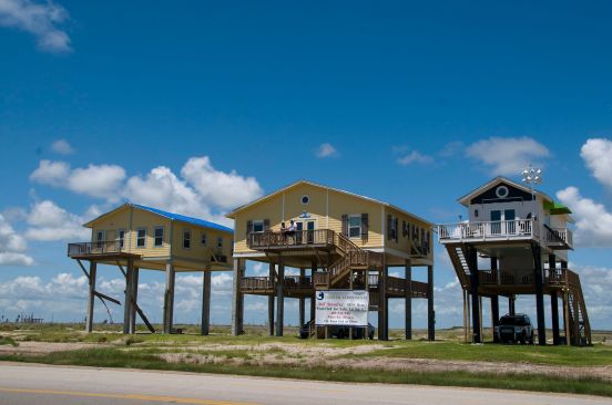

Gilcrest, Texas, August 16, 2009--Elevated homes constructed under upgraded standards of the IBHS Fortified program, which survived the arrival of Hurricane Ike, are the only structures standing in the town of Gilcrest after most of the area was scraped clean of structures by Hurricane Ike's storm surge.  Photo by Patsy Lynch/FEMA
Patsy Lynch
Gilcrest, Texas, August 16, 2009–Elevated homes constructed under upgraded standards of the IBHS Fortified program, which survived the arrival of Hurricane Ike, are the only structures standing in the town of Gilcrest after most of the area was scraped clean of structures by Hurricane Ike's storm surge. Photo by Patsy Lynch/FEMA

In practice, whether you’re concerned about storm surge or rising water from rain, elevation of a home is the root strategy for avoiding risk. The higher you build a home’s occupied space, the less likely it is to flood. And the way you elevate varies, depending on the type of flood you expect.
In the coastal velocity zone (“V zone”), where hurricane storm surge is the risk and wave action is the driving force, you need an “open foundation” on pilings, which allows waves to pass harmlessly below the home’s occupied space. Waves pack an enormous punch—measured in thousands of pounds per square foot compared with tens of pounds per square foot for wind. Because water is so much more massive than air, a 2-foot or 3-foot wave is far more destructive than any hurricane wind pushing against a structure. That’s why a 30-foot surge with high battering waves, like Hurricane Katrina brought in 2005, was able to scrape entire shorelines clean of buildings, including a total of 7,500 homes around Pass Christian, Miss.
River lowlands, where waves aren’t expected, are in the “A zone.” There, a foundation doesn’t have to be open; an enclosed concrete or block foundation is OK, as long as it has flood vents to let water in and out, equalizing pressure on the foundation wall.
In either kind of flood plain, official maps will supply a “base flood elevation,” or BFE. That’s the elevation that the 100-year flood is predicted to reach, if it happens. Depending on your local code, you may have to build above the BFE level by a foot, 2 feet, or even 3 feet—a safety factor known as “freeboard.” If the property has to carry NFIP coverage (which typically is required only if the house is mortgaged), freeboard can reduce the insurance premiums. The opposite, of course, is also true—homes that are below the BFE get smacked with steeper premiums.

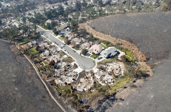

Wildfire entered this neighborhood in the Scripps Ranch area of San Diego and burned multiple houses in fall of 2003. U.S. Navy photo by PH2(AW/SW) Michael J. Pusnik, Jr.

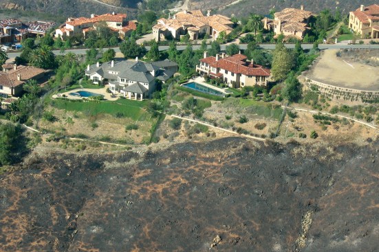

The Bridges, a Lennar Homes luxury development in Rancho Santa Fe, Calif., withstood wildfires that torched hundreds of other buildings in the area by applying "Firewise" landscaping techniques and building details. (Photo by Rancho Santa Fe Fire Protection District)
