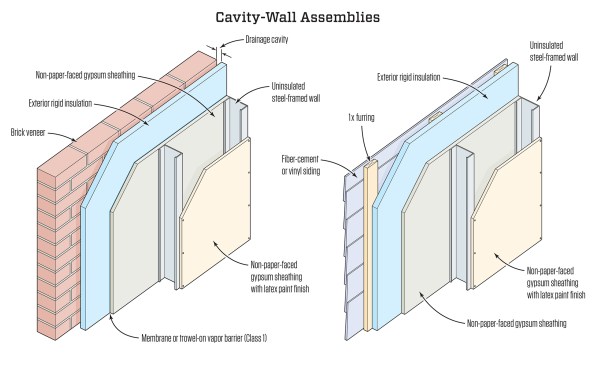

Following Hurricane Harvey, Lstiburek has evolved similar guidance tailored to the construction style that’s typical of the Houston market, where many homes are built on slabs and clad with brick (see the illustration "Flood-Tolerant Wall Reconstruction," above). In this go-round, Lstiburek is moving away from the idea of saving any interior wall covering. Floodwater tends to be “filthy,” Lstiburek observes, and interior wallboard is likely to be ruined every time the property floods—and probably has to come off in any case to allow thorough cleaning and disinfecting of the wall cavity.
In this latest incarnation of flood hardy, Lstiburek is assuming that the home’s sheathing will also have to come out, leaving the exterior brick cladding exposed from the back. All of the framing as well as the brick has to be washed, scrubbed, rinsed, and disinfected, he says, with particular attention to the base of the wall where dirt and sediment may have collected. Then it has to be dried.
When the wall is ready to be reconstructed, Lstiburek suggests two possible ways to establish an air barrier and drainage plane on the interior side of the brick cladding. One way would be to slide rigid closed-cell extruded polystyrene (XPS) insulation into the cavity between the brick and the studs, jamming the insulation into place with small pieces of XPS to hold it temporarily, and then applying closed-cell spray foam against the XPS and between the studs. This would create an effective air barrier and also achieve some lateral stiffening of the wall structure.
Lstiburek’s other suggestion is to place a fabric-faced open-weave drainage plane material such as Benjamin Obdyke Home Slicker against the brick, then apply the spray foam against the fabric for insulation and air-sealing.
Either method would create a drainage and drying gap behind the brick, outboard of the insulated wall. But first, says Lstiburek, the base of the wall should be coated with fluid-applied flashing to make a drain pan at the bottom of the wall. And weep holes should be cut at vertical joints in the bottom course of brick to allow water to exit the cavity.

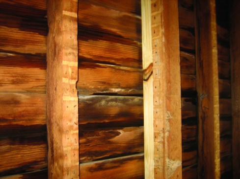

In historic New Orleans, there are many buildings where the old board siding cannot be removed.
SAVING HISTORY
Louisiana building-science consultant Paul LaGrange has been working with the LSU Ag Center since the days of Katrina, helping to design and develop the center’s LaHouse high-performance home demonstration project. After Katrina, LaGrange found himself working on flood restoration of old balloon-framed New Orleans buildings. Many of the structures were uninsulated, with board siding applied directly to the wood studs.
“Some of these were listed as historic properties, and some weren’t,” says LaGrange. “But either way, in many cases we weren’t able to remove the existing board siding. But we still had to improve the air barrier, the drainage plane, and the thermal barrier. And the way you do that with a historic house is very different from the way you would with a modern-construction home that was platform framed with structural panel or gypsum-board sheathing and interior drywall.”

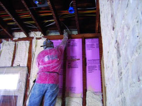

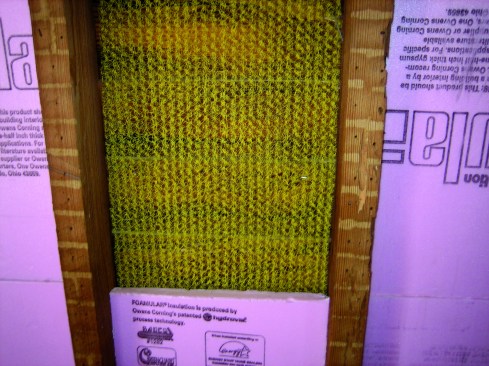

Consultant Paul LaGrange opted to place open-weave drain fabric against the wall, set rigid polystyrene insulation board against the drainage material.
He sealed the cavities with closed-cell highdensity spray foam insulation.
For those older buildings, LaGrange had to work from the interior. The methods he came up with (see photos, above) resemble Joe Lstiburek’s recommendations for brick-clad Houston homes: LaGrange placed Home Slicker against the board siding, cut and fit sheets of XPS to hold the drainage fabric in place, and applied closed-cell spray polyurethane to air-seal the wall and lock the components together.
Like Lstiburek’s recommendations for Houston, and like the drainable, dryable wall shown above, LaGrange’s solution for balloon-framed houses should make the houses easier to fix in the event that they flood again. But so far, none of the buildings LaGrange worked on have been flooded a second time.
Click to enlarge
Above is a rendering of two drainable and dryable cavity-wall assemblies proposed by building-science expert Joe Lstiburek after Hurricane Katrina. The wall designs share several key characteristics: No water-sensitive materials are used in the construction; exterior cavities are drainable and vented to the exterior; and interior cavities can be opened to allow passive or fan-forced drying in the event of a flood, by removing strips of wall material at top and bottom. Lstiburek cautions, however, that floodwaters are usually “filthy,” requiring the interior side of the wall to be opened up, scrubbed, rinsed, and disinfected.
Tim Healey Above is a rendering of two drainable and dryable cavity-wall assemblies proposed by building-science expert Joe Lstiburek after Hurricane Katrina. The wall designs share several key characteristics: No water-sensitive materials are used in the construction; exterior cavities are drainable and vented to the exterior; and interior cavities can be opened to allow passive or fan-forced drying in the event of a flood, by removing strips of wall material at top and bottom. Lstiburek cautions, however, that floodwaters are usually “filthy,” requiring the interior side of the wall to be opened up, scrubbed, rinsed, and disinfected.

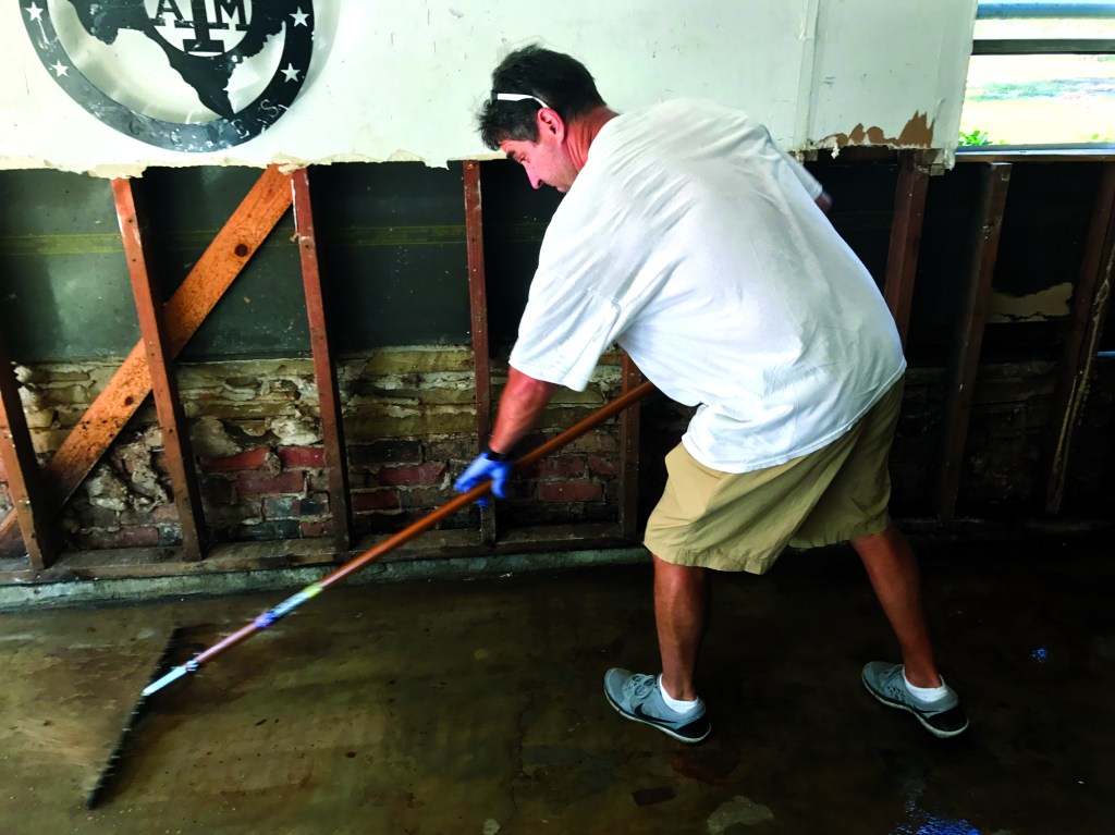

As JLC goes to press this month, Houston is not ready for reconstruction. Thousands of volunteers have flocked to Houston to help, but for now, the job is demolition. “They are focusing on gutting and drying,” says Paul LaGrange, “and they are actually drying it right. They are taking that four to eight weeks, depending on how long the water sat, and what products got wet, to dry those facilities. And of course they are sanitizing to prevent organic growth.”
In the 2016 Louisiana flood, LaGrange says, some homeowners were in too big a hurry. “They were not drying their homes thoroughly enough, to a 15% moisture content or less, before they started re-insulating and hanging drywall.” One common mistake is to measure moisture content at the surface of the wood, says LaGrange: “They weren’t inserting the pins of the moisture meter into the center of the wood framing to gather accurate measurements. So you still had moisture that was emerging from the center of that wood, and people were hanging drywall way before their homes were completely dry.”
Builder and JLC author Matt Risinger, who is based in Austin, Texas, has traveled to the Houston area with volunteers from his church to help gut several homes. At first, says Risinger, it was discouraging. “One of the houses I went to, the water was just absolutely disgusting,” he says. “The open-cell insulation was like a sponge. You could push on it and water would spurt out on you.”
“But by the end of the day,” says Risinger, “once we ripped out all the drywall and the foam, I felt like, ‘Okay, this house is salvageable. We’re back to a situation as if it was in framing and had gotten wet.’ And you know, houses get wet in framing all the time. We can deal with that, if it’s dryable.”

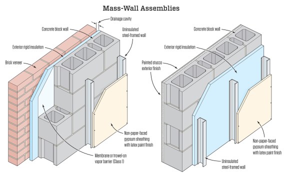

Click to enlarge
Masonry mass-wall assemblies proposed by Joe Lstiburek after Hurricane Katrina are reminiscent of traditional wall structures seen in historic buildings in New Orleans, some of which survived historic floods. Unlike the historic techniques, however, these insulated walls are adapted to modern space-conditioning and energy-efficiency expectations. The materials are chosen to be tolerant of water, and the least moisture-permeable material (the extruded polystyrene insulation board) is located at the center of the wall profile, so that moisture can diffuse out of the walls in two directions from the center.
Tim Healey Masonry mass-wall assemblies proposed by Joe Lstiburek after Hurricane Katrina are reminiscent of traditional wall structures seen in historic buildings in New Orleans, some of which survived historic floods. Unlike the historic techniques, however, these insulated walls are adapted to modern space-conditioning and energy-efficiency expectations. The materials are chosen to be tolerant of water, and the least moisture-permeable material (the extruded polystyrene insulation board) is located at the center of the wall profile, so that moisture can diffuse out of the walls in two directions from the center.
