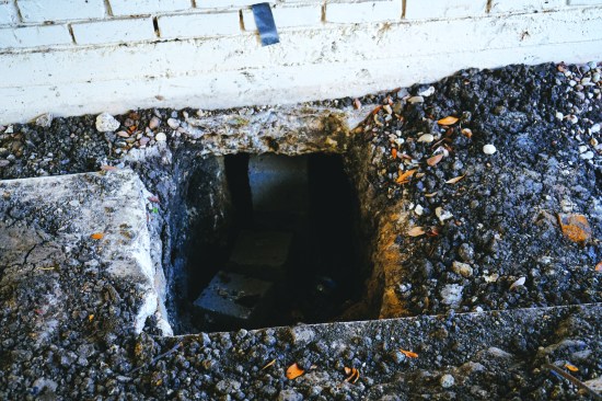

Here, Arkitektura’s tunnel crew has excavated tunnels along all the grade-beam footings.

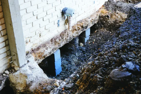

Solid blocks with center pins have been placed under the footings at close intervals and driven into the clay soil with hydraulic jacks to the point of refusal. Now, the house is ready for lifting.

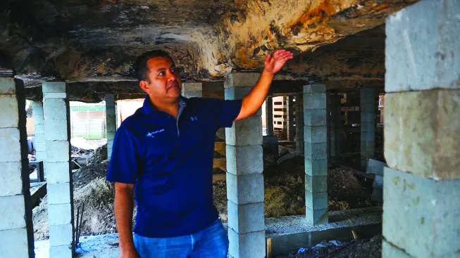

The house above has been lifted with a unified jacking system to its new elevation. Existing grade beams for the original slab are exposed and are supported by stacks of 6-inch-by-6-inch solid-core block with center stacking pins.
To lift the house, Contreras’s team starts by digging tunnels by hand beneath the house, to locate the grade beams. The beams are commonly found underneath bearing partition walls in the home above the slab, which provides a clue for the digging crew. Next, the team places solid-core concrete block with center alignment pins at intervals of 4 to 6 feet underneath the structural grade beams, along every grade beam within the home’s footprint as well as all around the perimeter. Using hydraulic jacks and stacking block atop block as they go, the crew drives the columns into the soil “to refusal”—at which point any further jacking would begin to lift the slab.
At that point, the crew cuts any structural connections between the existing grade beams and the existing bell-bottom piers. Individual jacks used to drive the new block piers are replaced with a “unified jacking system,” setting the stage for a slow, steady, continuous lift.

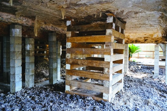

Lifting the Structure
Lifting a house can take all day, or even several days, using the unified jacking system. One central hydraulic pump operates all the jacks in the system, allowing smooth calibration and a simultaneous lift. “Most of these houses require a 24-port system,” said Contreras. Each port can run three jacks, so the system permits as many as 72 lift points under the slab. As the jacks slowly raise the house, the lift crew pauses the lift every so often to stack the cribbing and block supports higher under the building.
Large spans between the grade beams are temporarily supported by cribbing.

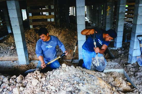

The crew is excavating for a new slab.

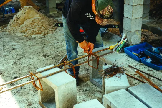

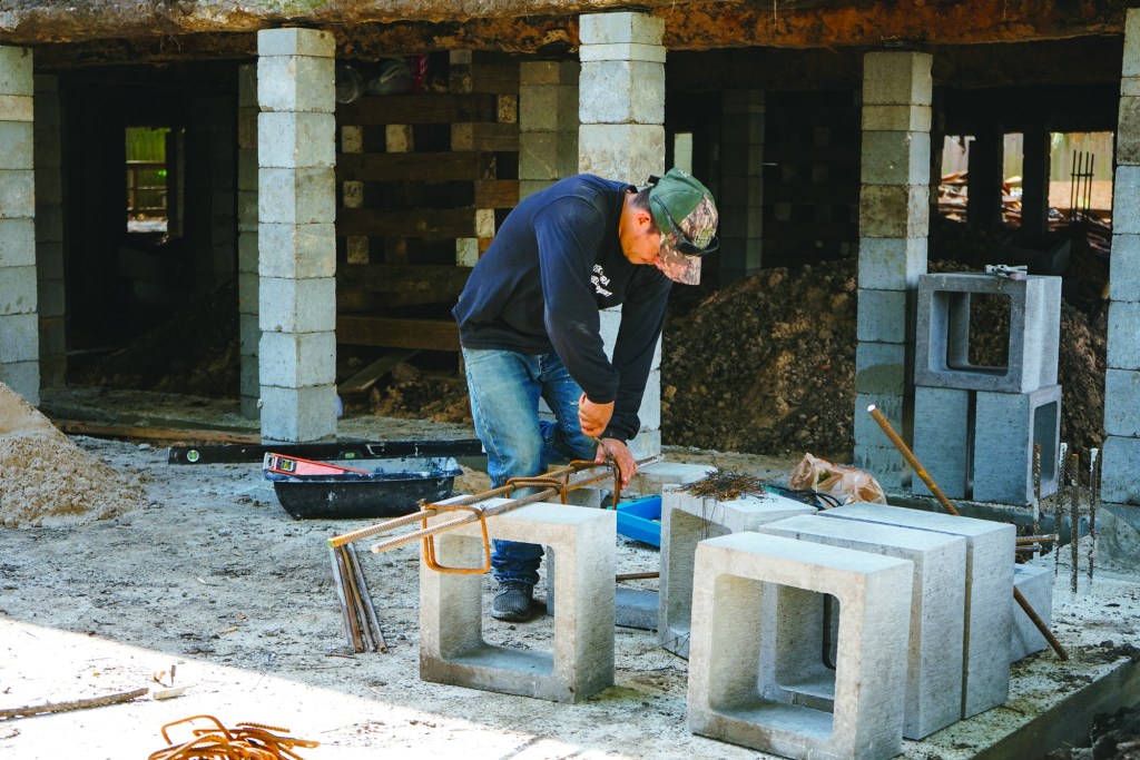

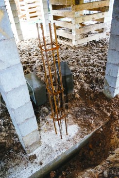

Supporting the heavy slab foundation and its house requires beefy new structure beneath the house. Here, a worker builds a rebar cage for a 16-inch-by-16-inch main support column.

Supporting the Slab

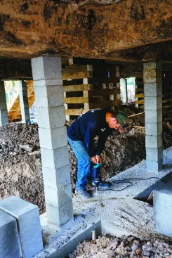

As the jacks lift the house and its slab up into the air, workers pause every 2 feet or so to stack additional blocks onto the supporting piers and to add cribbing in areas of the slab that span long distances between reinforced beams. Once the blocks and cribbing have gotten high enough to support the building at its new permanent height, the lift is stopped and the building is set gently back down onto the new supports.
The rebar cage will be set into holes drilled into the newly poured grade beam.
The original house was supported by its steel-reinforced concrete grade beams, which rested on the earth but were also supported by deep concrete piers with under-reamed bell footings. The reinforced slab of the original house had some capacity to span between these grade beams, but it was also partially supported by the ground. Once the house is lifted, the ground is no longer helping to support either the grade beams or the slab. So the new pin-block columns have to be spaced closed enough together to hold up the grade beams. Also, steel beams may be necessary at mid-span points under some wider areas of the newly elevated slab. In cases where the design calls for open spaces under the house for the homeowners to use, steel beams may also be used to support the grade beams between larger columns, in order to replace some of the block supports.

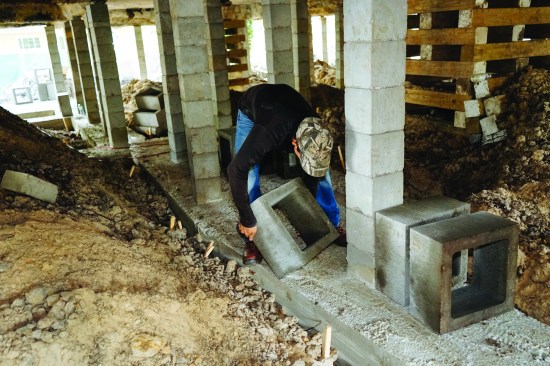

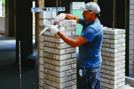

The crew member readies the heavy 16-inch-square block for constructing the column. Once the blocks are stacked and mortared in place, the pier will be fully grouted to create a solid masonry column.

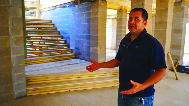

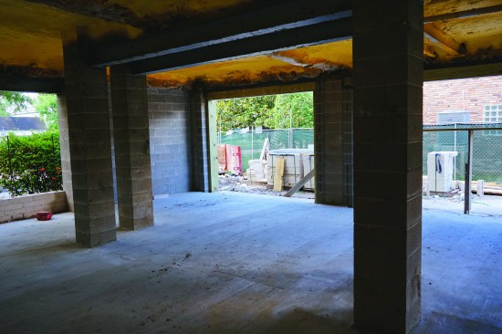

Arkitektura’s work is set apart from that of many house-lifting companies by the attention to architectural and finish detail. Above is a new entry stair in the grade-level space under the house.

Exterior decorative details are also key. Here, a mason clads a new exterior column on the street side of the building.

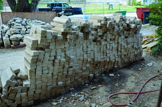

The crew used original matching brick salvaged from the home next door, which was demolished after the flood.

Architectural Finish Details
But Contreras brings his own expertise to bear in those final details: skirts, stairs, railings, and the like. “We use a little more time on the details at the base of the house,” he said, “to make it a lot more interesting and to integrate more into the house, instead of just looking like a house that was lifted and some masonry thrown up around it.”

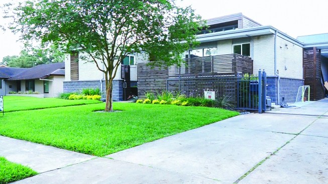

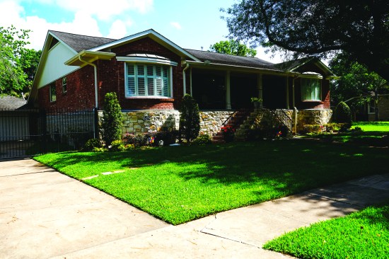

The leafy tree-lined streets of Meyerland define the neighborhood’s character.
Homes that are lifted high enough also get customization of the ground level.
