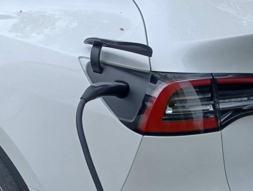

Most of the time, we simply install a NEMA 14-50 or 6-50 receptacle in garages. In my experience, the majority of EV owners are using a mobile connector, like the first-generation, 40-amp Tesla version shown in the photo at left. This has a hard-wired 14-50 plug, for which I wired a 14-50 receptacle about 5 feet above the garage floor using a 6/3 cable cable running back to a 50-amp breaker in the service panel.
Wall-mounted, 220-volt stations are typically drawing 32 to 48 amps. We often wire these to a short cable with a 14-50 or 6-50 plug (there are also off-the-shelf molded cable assemblies available at the big box stores) to go into a corresponding receptacle mounted on the garage wall. EV car and charging-station manufacturers usually recommend hardwiring the wall units to house power, rather than to a cord and plugging them into a receptacle, because you have fewer connections where the ground can be interrupted. But a lot of customers want the flexibility of taking their charging station with them to a second home or when they move. If you are installing a 48-amp unit, a 6-gauge cable will do nicely, but technically it should run to a 60-amp breaker, as the National Electrical Code requires electrical circuits to be rated for 25% greater amperage than the output. And if you’re using a 60-amp breaker in the panel and the home has only 100-amp service, the service should be upgraded, preferably to a 200-amp panel.
