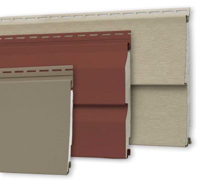

The thicker the product, the better it is for stability, rigidity, and impact-resistance. ASTM D3679 specifies .035 mils as the minimum thickness for certification, but most pros won’t use products less than .042 mils thick. You can find products on the market up to .055 mils thick, but be advised that overlap panel end joints will be more visible with the thicker material. For vinyl siding that has a more substantial look and feel, you can also choose premium insulated vinyl siding with either integrated or drop-in foam backing.

Avoid double- and triple-course panels on long walls. The stacked joints are a dead giveaway that the siding is not wood. Single-course vinyl planks are available in 5- and 7-inch profiles and are more easily installed with random butt joints.

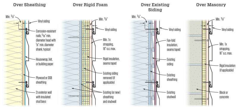

Vinyl siding must be installed over nailable wall sheathing that is perfectly flat and smooth, such as CDX (exterior plywood) or OSB. The sheathing must be protected by a moisture barrier, with seams taped to prevent water intrusion.
The Vinyl Siding Institute considers vinyl siding as part of a “water-resistive barrier system,” not a water-resistive barrier by itself. By its nature and design, vinyl siding works well as a supplemental rainscreen in the system, cutting down the amount of water that gets through to the water-resistive material covering the sheathing. Properly installed vinyl siding is attached somewhat loosely to allow it to expand and contract with temperature changes, so it’s always subject to some moisture penetration from wind-driven rain and similar sources of water. But because the vinyl panels are hollow and have slotted nail hems, they allow sufficient airflow as well as an escape path for moisture to easily drain off. The spaces and materials behind the vinyl dry out readily—even without strapping spacers, many claim.
Rigid foam board insulation applied on the outside of the sheathing is becoming increasingly popular these days. With the seams properly taped, this insulation layer can also provide an effective drainage plane behind the vinyl siding. Exterior foam insulation is typically fastened in place with long structural fasteners driven through 1-by strapping and into the wall studs. The strapping then provides a solid structure onto which to nail the siding. But with the siding nailed every 16 inches, heavier, stiffer vinyl panels should be used to prevent sagging between the strapping.
Vinyl siding can also be installed over sound existing wood siding. Typically, fanfold insulation is applied over the existing siding to bridge any butt seams and to create a flat plane for the vinyl panels. In these cases, door and window casings usually need to be built out to project beyond the finished siding.

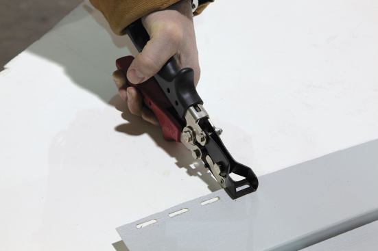

There are two specialty tools that every vinyl siding installer should carry. A snap lock punch creates raised “lugs” in the edge of a vinyl panel once the nail flange has been removed. The lugs lock into utility trim to hold the edge of the panel in place while allowing the piece to move with temperature changes. A slot punch makes an elongated hole for a fastener that allows the siding panel to move under the fastener head.

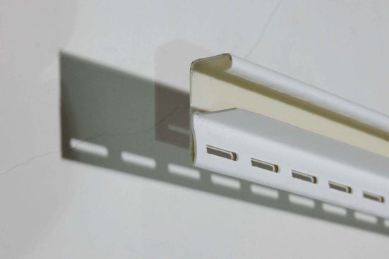

Use J-channel to capture and cover the ends and edges of siding panels. J-channel can also be used below the soffit to hide the edges of the panels. Another place for J-channel is along a roof-to-wall connection.

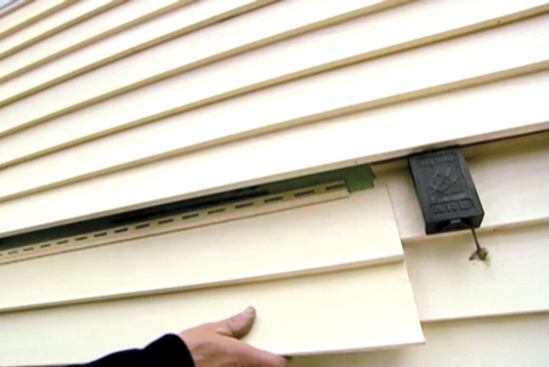

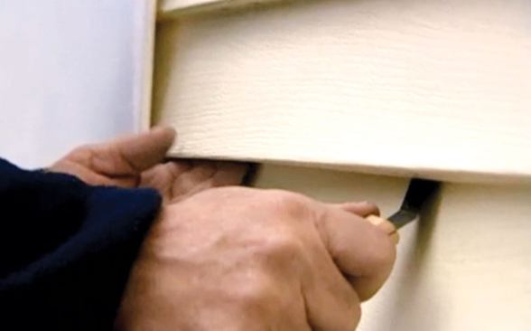

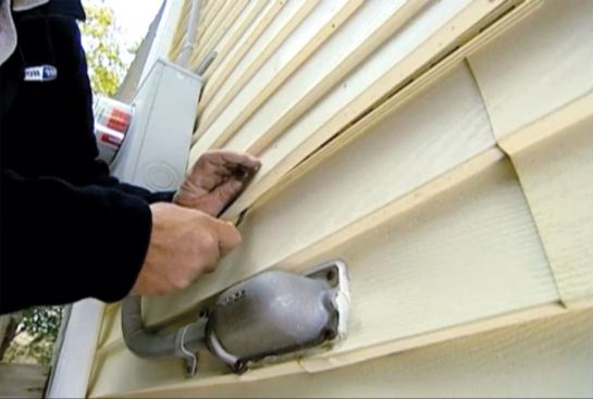

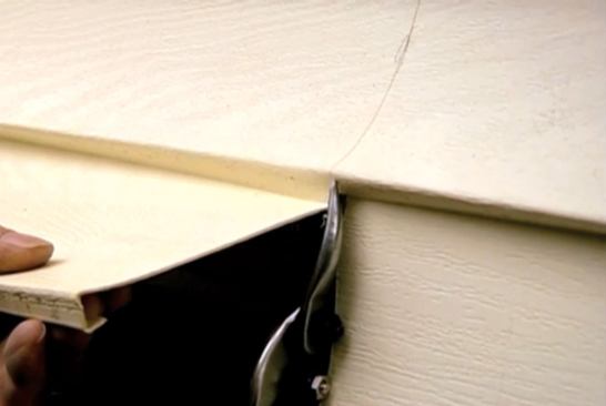

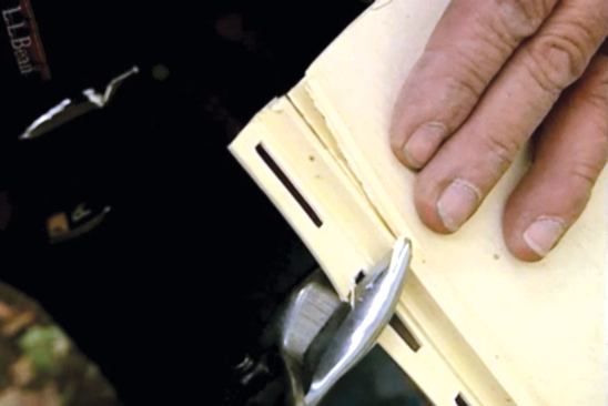

To remove a section of siding, first use a utility knife against a square to lightly score the face of the panel several times, then unlock the siding from the surrounding courses by hooking a zip tool under the interlock at the panel butt; pull down and across to unlock it. Snip through the panel butts to complete the cut. Lift the butt of the panel above, and pry out the exposed nails.
To insert a patch between existing panels, follow the same procedure to cut and remove a section that is a couple of inches shorter than the patch material you will be using. Before installing the patch, snip away a couple of inches of the nailing flange and the bottom J-section at both ends; this will allow the patch to overlap the siding to either side of it. With the patch slid into place, fasten it every 10 inches or so, driving the nails in the center of the nailing slots without pinching the panel, which allows it to move with temperature changes.

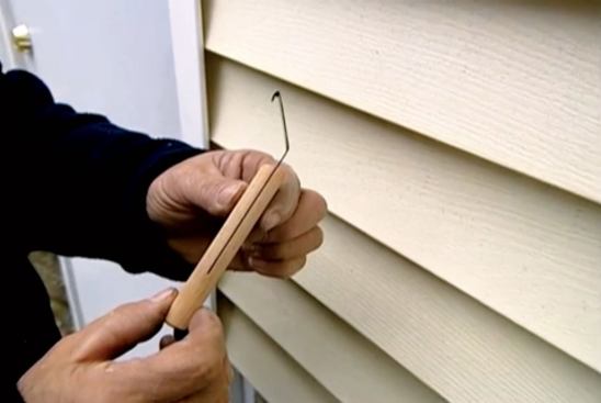

Finally, use the zip tool to reengage the patch to the panels above and below it. Hook the tool into the J-section at the butt, pull down, and slide the tool sideways while pressing against the siding with your palm to lock the pieces together again.
