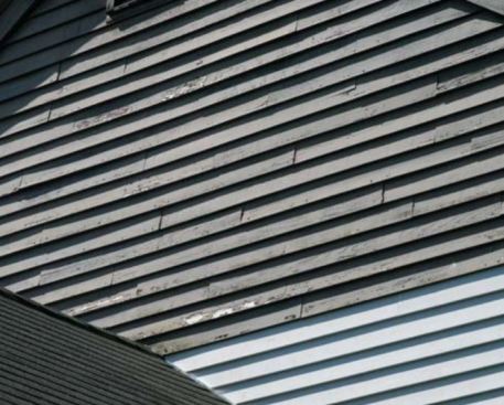

Moisture migrating from inside the home through the backs of the clapboards also attacks the adhesion of the paint or stain on the exterior wood surfaces, causing premature loss of the coating. The new preprimed clapboards at the lower right of this gable-end wall, installed as part of a window replacement, will perform much better in service.

Use preprimed material. The minute you put wood up on a wall, the sun starts to attack its fibers, and the wood begins to experience swelling and shrinking as it gains and loses moisture to adjust to the surrounding air. To protect the wood, every piece of siding or trim that is nailed to a building should be primed first on six sides—that is, on all four faces and on both ends.

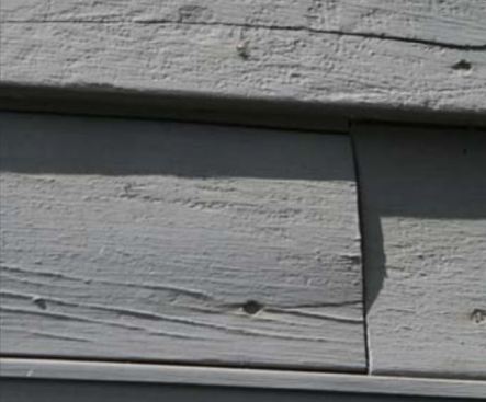

Without back-priming, daily and seasonal moisture cycling will soon cause beveled wood siding to cup and warp, as well as crack.

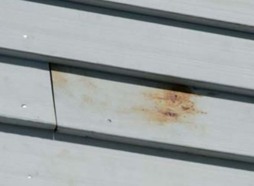

If you use unprimed material, you should prime it yourself before you nail it up. That includes priming the back face. Although it doesn’t face the weather, the back of a board is often attacked by moisture coming from within the house. Back-primed wood can resist that moisture, but wood that hasn’t been primed on the back will curl or cup. That unbalanced movement stresses the nailed connections, and moisture migrating toward the outdoors also attacks the bond between the coating and the wood, causing early peeling or wear.
Factory primer usually will not block bleed-through by extractive oils in cedar, as shown above. It also will not provide the "tooth" that helps finish coats bind strongly to the material. The author touch-sands or power-washes the wall (or does both), spot-primes areas of bleed-through with an oil-based stain-blocking primer, then primes the entire wall with regular acrylic primer before applying a finish coat of paint or stain.

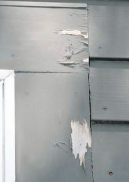

Field-prime all cut ends. Whether you use factory-primed material or prime it yourself, make sure to prime every cut end or edge. That’s easy to do—just keep a can of primer and a brush at the chop-saw station and have the carpenter who’s doing the cutting prime each end before he passes it to the carpenter who’s nailing.
If you don’t prime the cut ends, you’re leaving open the part of the wood that is most open to moisture entering: the end grain. Nature intended wood to draw water into the end grain. In service, unprimed ends will absorb water and swell, and paint will start to come off the wood at that location first. If painters arrive to paint or stain a house that is sided with clapboards whose cut ends are unprimed, or trimmed out with boards whose ends are unprimed, there is very little they can do to address the issue. So it’s up to the people installing that wood to make sure that the ends are primed.
Finger-jointed material. Many wood windows and doors are now assembled with finger-jointed wood. We also see a lot of finger-jointed siding and trim. If the wood has a factory primer applied, it may hide those joints, but it doesn’t protect them from the weather. So it’s important to prime finger-jointed material again as soon as possible after installing it. If those joints start to open up and let moisture in, they may not hold up the way they’re supposed to, and they’ll start to look bad as well.
Here, carpenters have installed factory-primed window casing material without sealing the ends. Stain was applied without any sanding or repriming. Failure has begun at unprimed ends, flat grain, and unsealed knots.

Water has entered unprimed end grain and caused the piece to check. If the carpenters had primed all cut ends, and if the original painters had prepped the wood and applied a fresh field primer, the onset of failure could have been postponed for years.

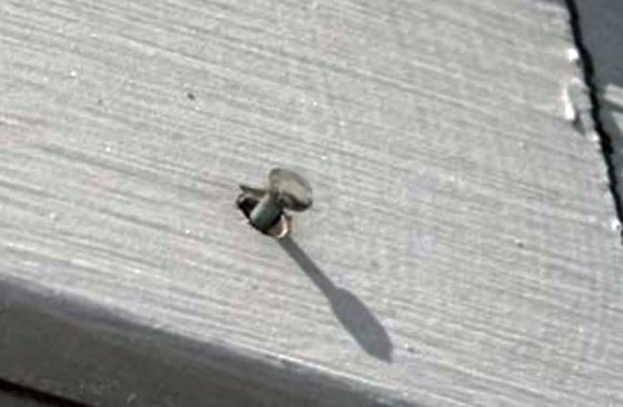

As wood expands and contracts with changes in moisture and temperature, smooth-shank nails may gradually work  proud of the board surface.
Nails matter. Use ring-shank or spiral-shank nails. When siding and trim are nailed with smooth-shank nails—even galvanized nails—daily and seasonal wood movement can work the nails loose from the material over time, leaving nails standing proud. On repaint jobs, our prep crew usually has to pull a lot of nails that are high, and we always replace them with ring-shank nails (either hot-dipped galvanized or stainless steel). There’s no good reason for a carpenter in new construction not to use ring-shank nails in the first place. In my experience, I’ve never found a ring-shank nail that has worked its way high of the siding or trim.

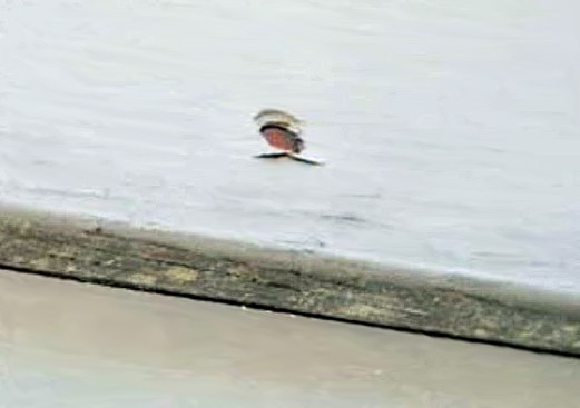

When carpenters overdrive gun nails beneath the surface of a board, water finds a place to collect and penetrate exposed wood fiber ends. Here, the coating has started to peel next to this nail hole, even on the shady north side of a house.
Be careful to drive nails just flush with the top surface of the wood, or perhaps just a hair lower. Good carpenters develop a feel for how to set the nails just right with the final tap of the hammer. But gun nails are harder to control, and carpenters may get in the habit of driving the nail heads into the wood. That’s bad practice—it provides a place for water to pool and attack end grain, and it creates a surface condition that is hard for primer to seal.
