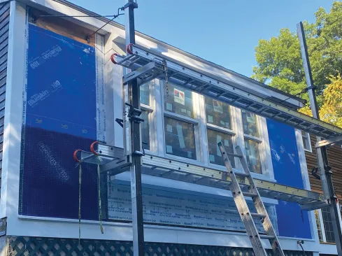

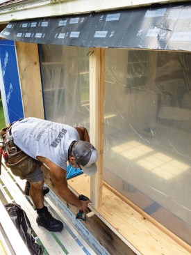

The author then completely covered the opening with sheathing to make it weathertight while he waited for the new windows to arrive.
Better water management. At the top of the box, a strip of aluminum flashing had been installed to cover the gap between the soffit and the box-bay framing and help divert water away from the window. It was securely tucked between the fascia and soffit and overlapped the box-bay frame, so even though it hadn’t done a very good job of water management, I left it in place temporarily, covering it with a wide strip of Vycor Plus flashing tape to better seal the flashing to the soffit. While I was working, I could fold the flashing back and out of the way; at the end of the day, I could bend it down over the opening.
Simply eliminating the gap between the upper 2×12 “header” and the soffit would help prevent water from running underneath the fascia and into the framing projecting out from the wall. Here, I installed 2×4 cripple studs, then sheathed the upper part of the assembly.

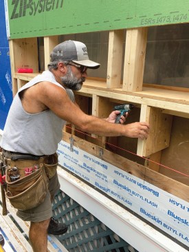

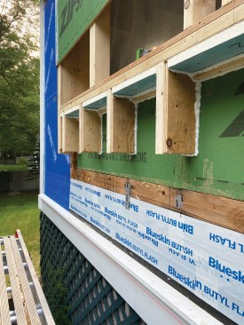

Structural support. To provide better structural support for the box bay, I cut away a 2-foot-high section of sheathing below the 2×12 subsill, removed the existing fiberglass insulation from the stud bays, then sistered 18-inch-long 2×12 blocks to the 2×6 wall framing below the window opening using structural screws. To reinforce the connection and prevent the blocks from splitting, I added a 3/4‑inch plywood layer to each block, again with plenty of structural screws. I notched the blocking to fit snugly around a 2-by strongback that I had installed beneath the subsill over the existing wall sheathing to stiffen the opening. While installing the blocks, I set up a string line to ensure that the bases of the blocks were aligned.
Reinforced with plywood and notched to fit, 2×12 blocks were installed to provide support for the 2×12 subsill, which cantilevers out over the 2×6 wall framing.
The author set up a string line to keep the blocking aligned during installation.

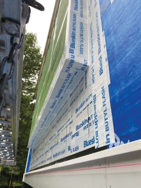

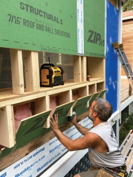

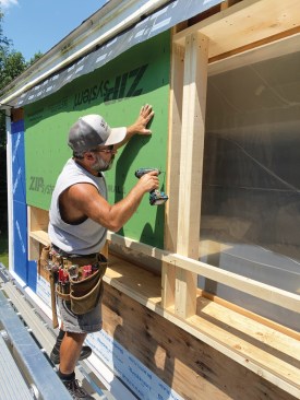

After refilling the wall cavities with fiberglass insulation, I resheathed the wall with Zip panels ripped to size and notched to fit around the blocking. Then I cut blocks of rigid foam to fit snugly underneath the 2×12 subsill between the blocking and sealed all of the joints with canned spray-foam insulation. Finally, I completed sheathing the box bay so that it was enclosed on all sides and taped the seams with Blueskin butyl flashing tape so that the box would be weathertight until the new windows arrived.
The author notched the new sheathing to fit snugly around the blocking.
The author then nailed the sheathing in place, insulated the subsill with rigid foam, and filled the gaps with spray-foam insulation.
After sheathing the entire box bay, the author flashed it with self-adhering butyl tape to the new WRB that he had installed over the wall.

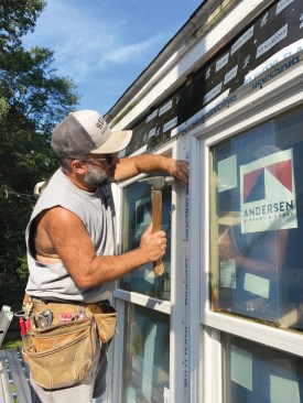

Window installation. Once the new windows were on site, I cut out the openings, added a beveled clapboard at the base of each one for positive drainage, and prepped the openings with flashing tape. As I installed each window, I bedded the top and side nailing flanges in sealant and left the bottom flange unsealed to allow for drainage. Then, before trimming the box bay with PVC trim, I taped the top and side flanges to the wall with flashing tape.
To install the windows, the author bedded the window flanges in beads of sealant at the tops and sides of each opening and nailed through the flanges and sheathing into the framing (left). Then he trimmed out the box bay with PVC, replaced the water-damaged roof fascia with PVC trim, and installed an angled PVC kick-out cap to cover the gap between the window trim and fascia and to divert water out and away from the windows (above).
