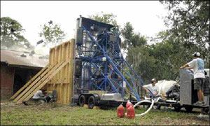

Tests conducted with the Institute for Business & Home Safety used a novel test rig developed at Florida International University to replicate roofing and soffit damage, which was common during the 2004 hurricane season (above). The apparatus (top), known as the “Wall of Wind,” relies on two air boat engines to deliver a torrent of wind and water.

IBHS site investigations and exploratory tests using a novel test rig developed at Florida International University (photo below) provided insight on issues related to wind-driven rain. Not surprisingly, the testing and observations clearly showed that complete loss of soffit material led to the most critical cases for significant water intrusion. This issue can be addressed best by properly installing soffit materials to make sure they stay in place during a severe windstorm (Figure 2).

Dye test. The wind-driven rain experiment was conducted by blowing winds up to 110 mph on a roof assembly with plumb-cut 2×6 rafter tails and a 24-inch overhang on a 6/12 roof. It produced a “boiling effect” as water pooled on the top of the panels and also worked its way up to the top of the 2×6 subfascia board.
Using a fluorescent tracer dye, it was possible to see water droplets accumulate in an attic with winds speeds as low as 90 mph (Figure 3). The same result could not be seen at 75 mph.
