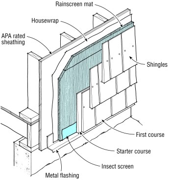

Drainage Planes for Shingles and Shakes
The most practical way to create a drainage plane for shingle and shake siding is with a self-draining rainscreen mat (below).
To create a drainage plane for wood shakes and shingles, install the siding over a drainage mat that will provide a channel to allow water down and out.
If the wall is furred out, horizontal battens will block drainage unless they are installed over opposing vertical battens (spaced 16- to 24-in. o.c.), creating a grid of strapping. Space horizontal battens the length of the shingle, and space vertical battens 16- to 24-in. o.c. With double thickness 1x battens, pack out windows, doors, and corners with 2x material.
Prior to installing strapping or a rainscreen mat, wrap and flash wall sheathing.

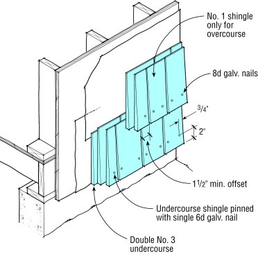

Double-Coursing
Double-coursing uses two layers of shingles (or one layer of shakes over a layer of No. 3 or No. 4 shingle). This application allows for wider weather exposures, and creates deep shadow lines at the butt ends (Double-Coursing, below).
Starter Course
Begin with a double underlay course or a single underlay course shimmed out the thickness of a shingle butt with wood lath. Nail undercourse shingles with a single nail in the center.
This approach to laying shakes and shingles features wide weather exposures and deep shadow lines. The outer course drops about 1/2 in. below the undercourse, which typically consists of low-grade shingles.
Face Nail
Double-course applications require face-nailing. Face-nail outer shingles with two nails placed about 2 in. above the butt line and 3/4 inch in from each end. Shingles wider than 8 in. get two more nails driven near the center, about 1 in. apart. The outer course drops about 1/2 in. below the undercourse.

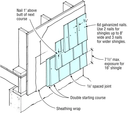

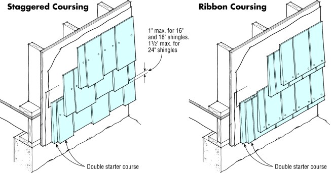

Single-Coursing
Single-coursing is quicker and less expensive because less material is used for a given wall area. However, it requires a narrow weather exposure (Single-Coursing, below).
Each course is blind-nailed about 1 in. above the butt line, using two nails for shingles up to 8 in. wide and four nails for larger ones. Offset joints in successive courses by at least 1 1/2.
Starter Course
Double the first course using inexpensive, lower-grade shingles (No. 3 Black Label or No. 4 Undercoursing).
Blind Nail

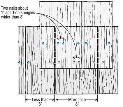

Drive nails about 1 in. above the butt line of the course above. For shingles up to 8 in. wide, use two nails per shingle about 3/4 in. from each edge. For wider shingles, drive two more nails about 1 in. apart near the center (Preventing Splits in Wide Shingles, below).
Staggered Coursing
For visual effect, butts can be staggered below (not above) the horizontal line (Decorative Coursing Variations, above). The maximum distance to stagger the butts varies with shingle or shake length: Stagger 1 in. for 16’s and 18’s or 1 1/2 in. for 24’s.
Wide side-wall shingles (over 8 in.) are prone to splitting. To avoid problems, blind-nail as shown above.

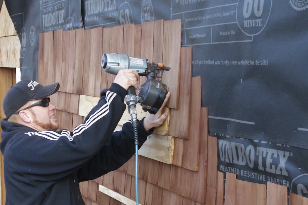

Fastening Checklist
Nails
  • Install sidewall shingles or shakes with rust-resistant box nails or special shingle nails long enough to penetrate the sheathing (or nailing strips) at least 1/2- to 3/4-in. Nails should be hot-dipped galvanized, Type 304 or 316 stainless steel, or high-tensile aluminum. (Type 316 is required within 15 miles of salt water.)
  • Drive nails flush to the shingle or shake surface, but not hard enough to crush the wood fibers, which could split the wood.
  • For single-coursing, 3d or 4d shingle nails are commonly used. For double-coursing, 3d or 4d nails are typically used on the undercourse, and 5d box or shingle nails are used on the outer exposed course.

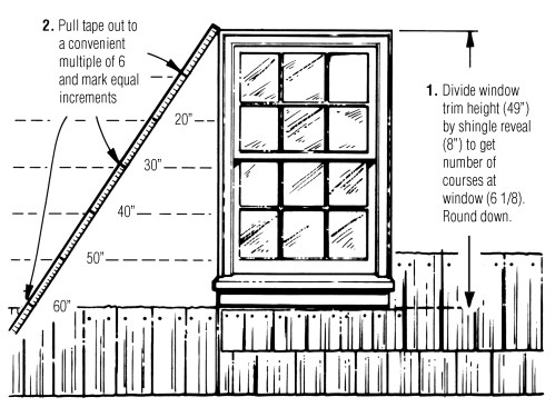

Aligning Courses
To determine the number of courses, divide the height of the wall into equal parts whose length is not greater than the weather exposure for the shake or shingle. Wherever possible, align shingle butt lines with the tops or bottoms of windows or other openings. This may require adjusting a few courses by a fraction of an inch (Even Shingle Layout, below).
To find the number of shingle courses between the top and the bottom of a window: 1) Measure the window height plus the trim. Divide this number by the average shingle exposure. If the resulting number is a fraction, choose the nearest whole number. 2) Hold a tape measure at the corner where the head trim will be, and pull it out to an even multiple. To find the course lines, mark off the even multiples.
