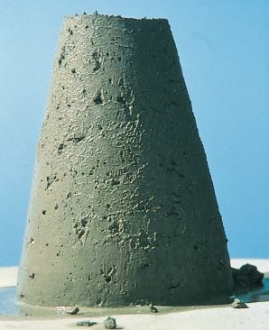

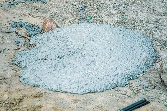

In Figure 7, the top left photo shows what an engineer likes to see – nice stiff concrete. In the top right is what the guys with the shovels like to see – soupy wet concrete that flows naturally. Somewhere in between is a happy medium that is wet enough to be workable but dry enough to result in good hard concrete.

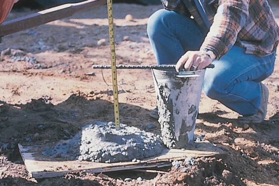

On site, the accepted way to gauge and control water content is the slump test. To do the test properly, use a standard cone 12 inches high, 4 inches wide at the small end, and 8 inches wide at the big end. You fill the cone up about 1/3 full, rod it 25 times, fill it up to 2/3 full, rod it 25 more times, and then finally fill it to the top and rod it again. Then you remove the cone and measure the slump from the top down. This picture shows a 9-3/4-inch-slump concrete – a very pourable concrete.
Although the slump test is basic concrete practice, not everyone understands it. I’ve even seen guys measure from the bottom of the pile of concrete up instead of from the top of the cone down. Then they’ll say, “I’m doing a 2-inch slump concrete.” If they understood the test they’d know they have a 10-inch slump, not a 2-inch slump. That’s a pretty wet mix.

Concrete work is heavy labor, and there’s an understandable desire to pour a higher slump, just to make the concrete more flowable. Suppose you go ahead and increase the slump by adding water? As a rule, it takes a gallon or more of water per yard to add about an inch to your slump. So to increase the slump from 5 inches to 9 inches, you’d need to add about 4 or 5 gallons. That could reduce the strength of your finished concrete by as much as 1,000 psi.
If you need such flowable concrete, you should get your supplier to teach you about superplasticizers. If you start with a 5-inch slump and then superplasticize it, you can get an 8-inch or 9-inch slump that is relatively easy to work with. And because you don’t have to add water, you’ve maintained good strength.

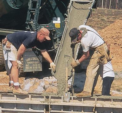

Very flowable concrete is the easiest concrete to pour. When you see concrete slurping down the chute like this, it’s a good bet that the crew has souped up the concrete with a lot of water. I call this technique “irrigating the forms.”

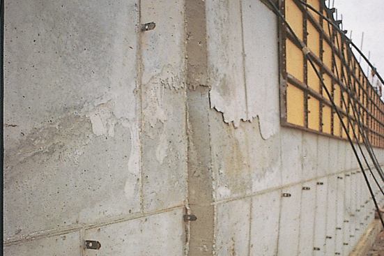

Now, you can do a good job with very flowable concrete if you move the chute and puddle the concrete where it is intended to be. But if you dump a whole lot in one corner and then pull it along the form with hoes, the aggregate starts coming out of the flow and separating from the cement. Where there’s a lot of gravel in one place and not enough cement, the result is honeycombing. A result like this usually means that someone tried to make the concrete flow too far. You can also see the results here as visible lines in the wall.
You’ll also get lines like that if there’s a delay between one lift of concrete and the next, especially if you pour a wall in hot weather. Once you start a wall pour, it’s best to keep the concrete coming at a steady rate, and not allow part of the wall to set up before the next lift is placed on top of it.
