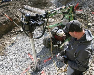

Figure 4. As the driver turns the pile, it simply screws into the ground until the installer is confident it's below the frostline and in soil with sufficient bearing capacity.

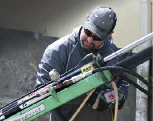

Helical piles are screwed into the ground to below the frostline using hydraulic machinery (Figure 4). The load-bearing capacity of a helical pile usually relates to the amount of torque required to install it, a function of both the size of the helical plate and the soil’s bearing capacity. A pressure gauge on the installation machine reads the torque as the pile is rotated into the ground (Figure 5).
Figure 5. The helical pile's bearing capacity usually relates to the torque required to drive it. A gauge on the machine measures the hydraulic pressure, which correlates to the torque.
If the soil is weak, the pressure gauge will read low numbers, which means the pile must be screwed in deeper to stronger soil. When the helix is below the frostline and the pressure gauge hits a high enough number relative to the loading requirements of the structure, the installation is complete. This pressure reading is plugged into a formula called a torque correlation that calculates the actual bearing capacity of the pile.

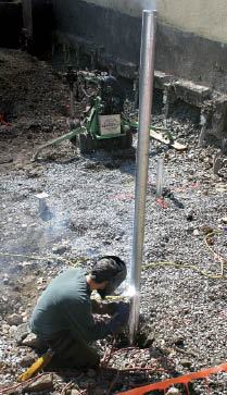

Figure 6. Additional lengths of shaft can be welded on, and the pile driven as deep as needed to reach soil with adequate bearing capacity.

When poor soil conditions mandate going deeper than the standard 7-foot-long shaft, an extension is welded on (Figure 6). Sometimes all it takes is a foot more depth to go from utterly terrible soil to rock-hard soil. This is particularly relevant if you’re building a free-standing deck where the piers close to the house might start out in backfill. With a concrete footing, you have to dig down to virgin ground at the house foundation level, as much as 7 feet or 8 feet if the house has a basement. It’s no problem to drive a helical pile to this depth (Figure 7).

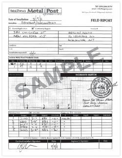

Figure 9. A field report filled out by the installer notes the piles' location and depth and either their torque readings or the amount they sank in a sledge-hammer test. The report is sent to an engineer for review and stamping.
For instance, footing inspections aren’t required. The installer records the pressure readings, pile depth, and load-test results for each pile in a field report (Figure 9). The company I work with can then have the field report stamped by an engineer and sent directly to the building department, if required. (Some departments don’t require a stamp. Your local installer will know the acceptable way to proceed.) The cost of this engineering is built into the cost of every helical pile we install; a different manufacturer may charge separately for an engineering report.

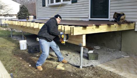

Figure 13. Because helical piles' load capacity can be verified,  it's often possible to use fewer footings and a larger support beam. In this case, the span between piles is over 15 feet.Photo credit: Greg DiBernardo
With helical piles, the torque correlation combined with per-pile load testing also means there is no need to test the soil capacity or rely on guessing. You will absolutely know the bearing capacity of each pile (Figure 13)
