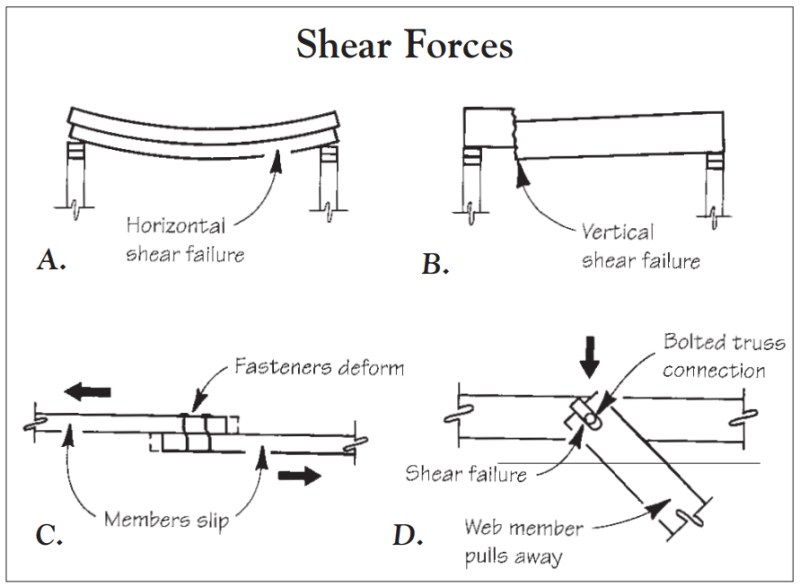

Shear force causes adjacent materials to want to slide or slip past one another. In a wood member, horizontal shear (A) acts parallel to the wood grain, while vertical shear (B) acts across the grain. The movement of a member with respect to a fastener may also be the result of shear force (C). Shear also describes the movement of two members with respect to their original positions, as in the example of a bolted truss web member pulling away from the top chord (D).

Shear
This is a type of force that wants to make adjacent materials move past each other (see image below). This includes: The movement of adjacent wood fibers within a member in a direction parallel with or perpendicular to the grain The movement of two individual members with respect to their original positions The movement of materials with respect to fasteners such as nails, screws, or bolts.
When you see the phrase lateral load, this refers to shear forces acting in a direction parallel with the ground surface. The causes of these lateral loads can be wind, retained soil, water, earthquake, or impact by an object. Stability of a structure is achieved only when lateral loads are properly distributed through the structure, into the foundation, and out into the surrounding soils.
