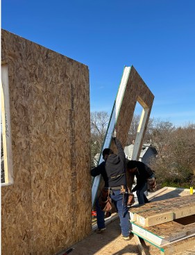

The Queen of Zero framing crew installs one of 90 structural insulated panels (SIPs) that comprise the home’s exterior shell (first and second floors).

Currently, the enclosure of the Queen of Zero – a custom single-family rebuild in Maryland and the 2024 JLC Case Study home – is taking shape. The exterior shell is being built from energy-efficient structural insulated panels (SIPs), each consisting of two roughly 4-by-9-foot sheets of OSB sandwiching a core of EPS insulation. The SIPs at Queen of Zero were manufactured by Acme Panel company and shipped flat to the site.

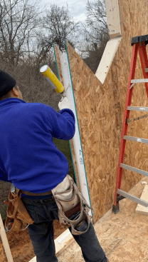

Each 6 1/2-inch-thick panel was manufactured to exact specifications and labeled for its location and sequence in the installation process. The panels arrive with horizontal and vertical ducts ready for electrical wiring. During installation, panels are sealed on all four sides with either spray foam or SIP seal adhesives, depending on the connection.

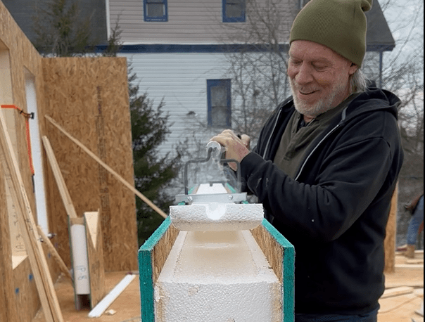

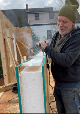

SIP modifications in the field are rare, but occasionally minor adjustments need to be made. Builder Matt Kulp uses a heat-activated SIP Groover to trim the EPS foam of a panel to prepare for installation at an outside corner at the Queen of Zero project.

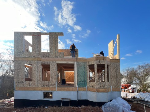

The Queen of Zero framing crew installs structural insulated panels (SIPs) on the second story of this Net Zero Ready Home in Maryland. The super-efficient panels have a near continuous “beyond code” thermal resistance of R-24.
