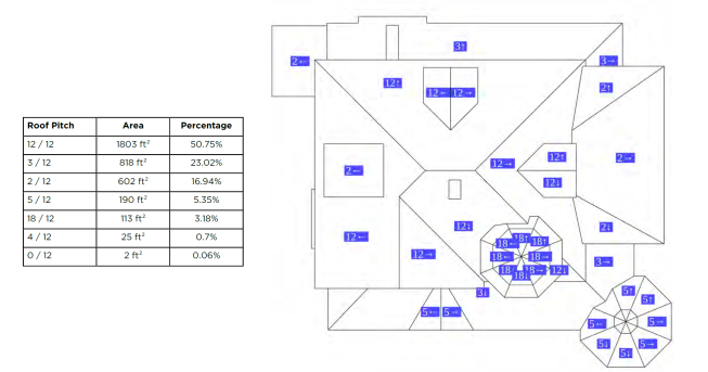

Early in the design process, our team determined that solar panels would not be a good option for this new Queen Anne Victorian-style home. In addition to panels looking somewhat odd on a turn-of-the-century design in a historical neighborhood, we also had the challenge of limited space for panel placement due to the amalgamation of hips, valleys, and dormers presenting no less than seven different roof pitches on the Queen (see image, below).

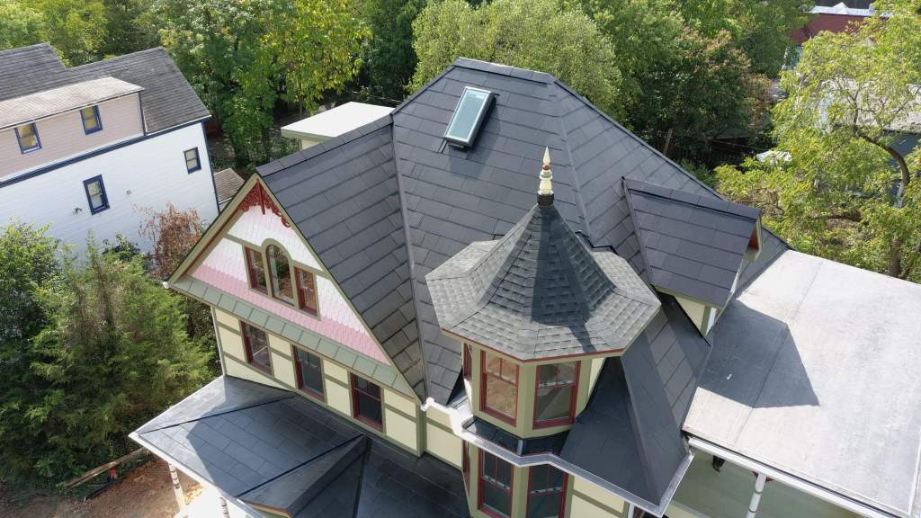

For this project, solar shingles offered a better alternative to panels – both in terms of aesthetics and potential energy production. There are multiple PV shingles on the market today, but only one product, the Tesla Solar Roof, evokes the look of slate material used on historic homes. Furthermore, the active (that is, wired photovoltaics) and inactive tiles of the Tesla roof blend together seamlessly, appearing as one consistent material. Most solar panels yield more energy per square foot than a typical solar shingle. However, at the Queen of Zero project, the full array of solar shingles proved more effective because the shingle is smaller, and installers could fit more units within the county’s rooftop PV setback requirements. The Queen’s roof supported 172 active solar shingles for a total 12.3kW system size (see image, below).
The layout for the 172 PV panels superimposed on the roof plan of the Queen of Zero.
Image courtesy American Home Contractors

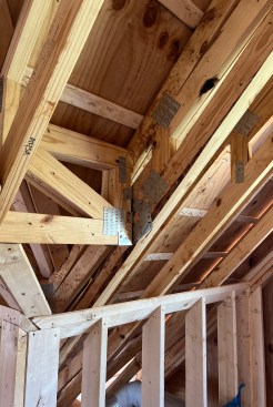

To meet the recommendation for natural ventilation, the Queen’s design team had to devise a strategy that would allow air movement despite the complicated geometry of the four-sided hip roof structure. We used ¾-inch purlins between the roof plywood and the trusses to create a pathway for air to reach the ridges. Next, we installed 1-inch sturdy baffles on top of the purlins (see photos, below). We covered the baffles with spray foam to air-stop and insulate the attic. The result is a vented air channel over an unvented attic space.
To facilitate the natural roof ventilation required for Tesla solar shingles, the crew installed 3/4-inch battens on top of the roof trusses.
In each  bay, the battens are covered with sturdy plastic baffles, shown here before the spray foam roof insulation was applied in each bay.

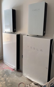

The Queen’s renewable energy system includes two Tesla Powerwall backup batteries, each storing 13.5kWh of power. The batteries extend the benefits of the solar roof. During the day, when sunlight is plentiful, the backup batteries fill up on excess solar power. At night when the sun goes down, the battery power can be used rather than pulling from the grid. This system not only reduces utility costs but also helps support a more sustainable and stable electric grid.
The two Tesla Powerwall backup batteries (positioned along the bottom), each with an inverter (at top).
The Queen’s renewable system is also designed to draw energy from the backup batteries in the event of a power outage. It may seem counterintuitive but, typically, interconnected rooftop solar systems do not function during an emergency outage—even if the sun is shining. The electric utility must shut down PV arrays to prevent dangerous electric currents on the grid. However, the Tesla system includes a gateway controller that permits the solar shingles to continue working by feeding power to the batteries. Tesla Powerwalls have a “stormwatch” mode that monitors the weather and will fill up, as needed, in advance of inclement weather.
According to Nick Zavala, president of American Home Contractors, the Queen’s backup system is designed for “energy independence.” In a total blackout without solar support, the batteries can maintain essential functions in the house for up to three days. Given a minimal amount of sunshine and a protocol for priority circuits, the “system can continue to work in perpetuity.”
