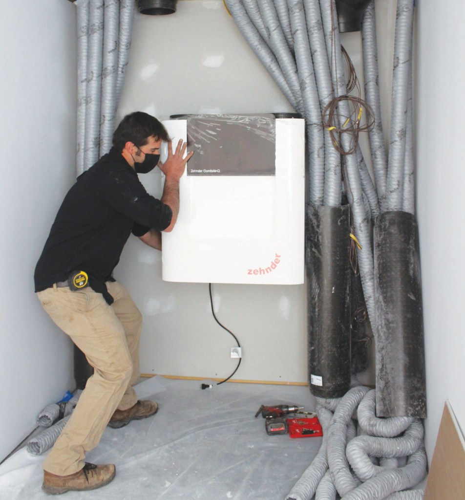

It’s not complicated: Start with a tight building shell and a stand-alone ventilation system with energy recovery. When you have airtightness combined with energy-recovery ventilation, the house doesn’t fill up with dust and dirt. If you are a production builder, could you sell that? Yes. And it’s peacefully quiet inside. Can you sell that? Definitely. Builders can’t sell airtightness. They probably can’t sell IAQ. But we can show a customer 1) less dust and dirt; 2) it’s quieter; and 3) oh, by the way, it’s better for your health—you don’t feel your allergies, and it affects health and longevity and mental alertness (see “Health Effects Tied to Buildings,” right). When you show all that, the customer is likely to respond with, “Yes. I’d like all three of those.”
A tight shell and balanced energy-recovery ventilation is a simple equation to get you there, but success from a builder’s perspective requires one person to take charge of optimizing the heating/cooling systems with balanced ventilation, airtightness, and the thermal boundary, including windows.
Stand-Alone vs. Integrated Systems
Mark LaLiberte: Agreed. This may be simpler than we think if we can boil it down to some basic systems. A balance between energy use and health is found when we combine a tight, high-performance shell, so we gain control over thermal gains and losses, with stand-alone ventilation—a system that delivers balanced supply and exhaust air streams with energy recovery, and that runs continuously. When this is the default, everything gets a lot simpler.
Integrated systems, particularly in hot, humid climates, are problematic. We have huge problems right now in the Southeast with houses being ventilated with conventional supply-side or exhaust-only ventilation raising indoor relative humidity in buildings that can’t properly dehumidify. So we’ve got condensation on clothes dryer vents and bath fan ducts and on recessed lighting fixtures. This argues for a stand-alone energy-recovery system that can help pull out some of that moisture. The basic system starts with being able to run a fan continuously to move air throughout the house. And with energy recovery, you’re able to at least extract the moisture from the incoming air in hot, humid climates and reintroduce that to the outdoors.
In the work we just finished at CI [Construction Instruction], we kicked the ventilation rates up, validated fan performance, and showed that you can ventilate at 140 cfm and consume only 23 watts of electricity, recover about 85% of the energy in whichever stream you want, and reject 40% of the moisture from incoming air.
Builders need to know that the cost of ventilation with energy recovery is substantially lower than it has ever been.
Builders need to know that the cost of ventilation with energy recovery is substantially lower than it has ever been. And I think that’s the prime choice. And it’s often the simpler choice. The project that we’re working on in the Southeast is with a large national builder. They were running a supply-only ventilation system, taking in 60 to 100 cfm of outdoor air and running it through 500-watt, 70-pint dehumidifiers, and then introducing that air to the return side of the furnace on the air-conditioning side. This uses additional electricity and dumps dry air into the system before it hits the evaporative coil, wasting the potential of the coil to take out any of the moisture. If the builder chooses to run an energy recovery system instead, they will have a reduced need for dehumidification. In a lot of climates, dehumidification may not be needed at all. But in regions with high summer dew points, an ERV and a dehumidifier may be needed if you are selecting a higher ventilation rate.
BH: Getting the right amount of air in the house starts with putting in a stand-alone ERV that runs continuously. We breathe constantly so you want to deliver constant airflow throughout the house. An integrated system with a variable-speed fan that is turned down to low and is pumping 150 cfm so the air is mixing throughout the house might be OK. To my knowledge, no one has done a careful study comparing the air delivery of integrated vs. stand-alone systems, so I can only give my best WAG, but I’d wager an integrated system can deliver just 40% of what a stand-alone system can deliver. Why would you go with 40% when you can deliver fresh air everywhere in the house?
My preference is always a dedicated, stand-alone ERV. We have units that run at 80% to 90+% efficiencies. These can recover up to 90% of the heat and up to 60% of the humidity. This humidity control makes sense in most parts of the country to keep indoor humidity levels comfortable. Most of the industry is still saying that HRVs are generally needed everywhere except in hot, humid zones, but we are finding that ERVs make much more sense for most of the U.S. These units are a little more expensive, but you can eliminate the bath fans, saving some money, and eliminate the extra penetrations through the roof. You now have 24/7 air moving with no cycling on and off, so you’re getting the air needed for good health. And it’s cheaper to run because you aren’t relying on a higher wattage fan in an air handler to move fresh air throughout the house.
