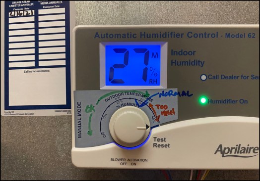

In the author’s climate, his company recommends clients set controls at 35% RH or lower (shown here marked up with colored pens), based on its experience that most buildings can handle 40% to 45% relative humidity in winter without moisture problems, and allowing for some inaccuracy or drift in the sensor.

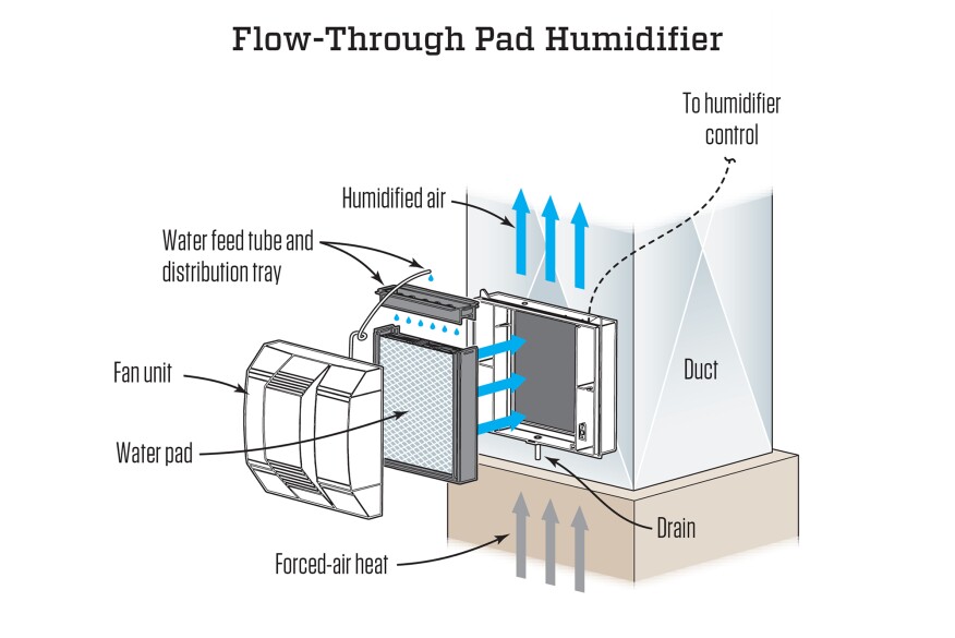

Flow-through pad humidifiers use a disposable pad about a foot square by 2 inches thick. Water is piped to the top of the pad and trickles down, while air is blown through the pad. The large surface area encourages evaporation. In the off cycle, the pad dries quickly so mold doesn’t seem to grow on it, and some pads are treated with coatings that resist biological growth. These humidifiers are reasonably effective and are not expensive to install or maintain. They do use a lot of water, depending on how they are set. Much of the water doesn’t evaporate and instead heads down the drain. When you’re paying a lot for water and sewer, this adds up. Not to mention that many of these devices recommend using hot water, which obviously increases energy use.

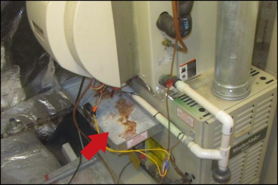

We’ve seen a lot of pad humidifiers leak a bit of water, especially on startup in the fall. For this reason, we usually recommend them only for areas that can handle some splashing. Adding a pad humidifier to an upstairs system is risky, even when we’re able to install the oversized drain pan we insist on for new installations. (When possible, we run HVAC closet drain pans from frame to frame, before drywall, so even splashing or spraying can land in the pan.)

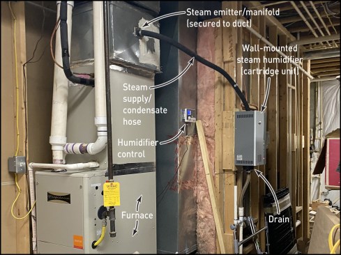

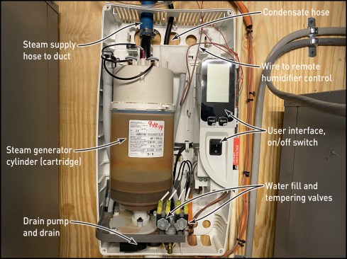

Steam cartridges. The second type of humidifier we use is a steam cartridge unit. This heats water in a replaceable plastic cartridge and pipes the resulting steam into an emitter in the ductwork.
Steam humidifiers are powerful and can put out terrific amounts of moisture—so much that we have to be careful with them. We’ve learned to install at least one safety device when we use these, either an “airflow proving switch” that won’t let the humidifier run if the HVAC fan is off, or a humidity safety switch that turns it off if levels inside the ductwork get too high. One of our HVAC subs installs both devices in case one fails. A problem with a steam humidifier is a big problem! I’ve seen two failures; both were discovered when water poured out of seams in the ductwork and soaked through ceilings and walls. The cleanups were big projects. Other issues I’ve seen with these are melted PVC drain pipes (follow installation instructions—usually the first few feet of drain should be metal) and a strange situation where all the steam went down one branch duct, overhumidifying one part of the house while leaving the rest of the house dry. (Moving the emitter solved that issue.)

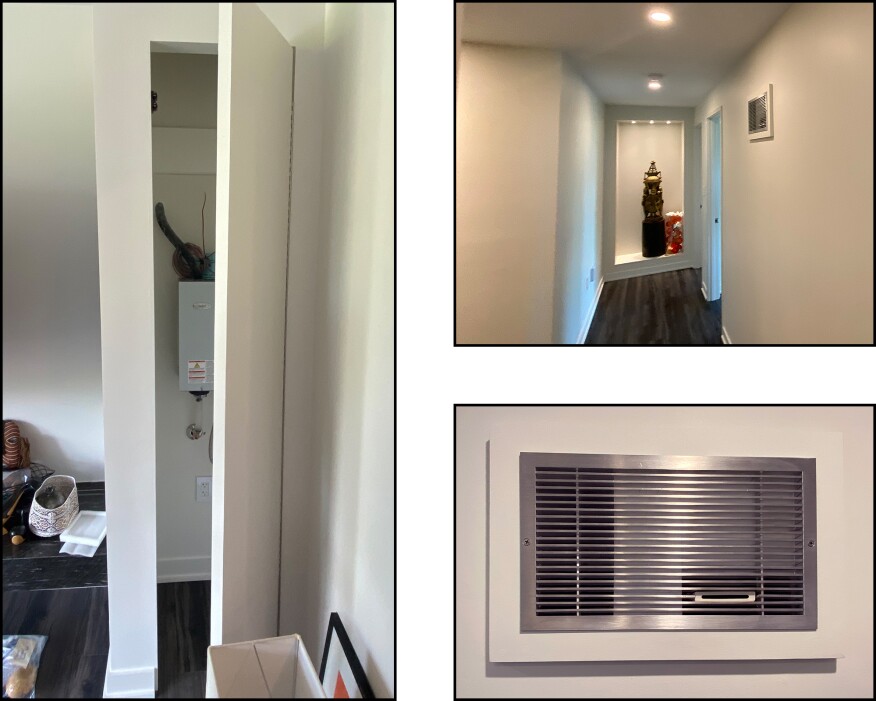

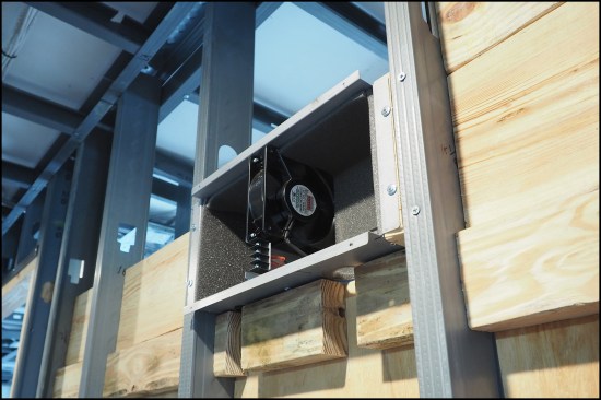

If your building doesn’t have ductwork, there are options. We’ve installed a few steam humidifiers with a special wall emitter box that has a fan to mix air with the steam to help blow it around the home. I also recently saw a pad-type unit with its own built-in fan for a free-standing installation.
Steam humidifier cartridges do accumulate minerals and debris from the water supply, but they are easily replaced—typically annually. They are designed to fully drain in the off cycle.

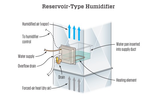

Reservoir humidifiers. Taking a cue from my indoor air quality friends, we no longer install reservoir humidifiers—whole-house units that fill a bucket with water and energize a heating element in the water. Because organisms grow in the water easily, this type of humidifier is a maintenance headache, requiring multiple thorough cleanings per heating season. An even worse version runs a wicking device (like a belt or disks) through the reservoir so water evaporates off the wick. These gunk up even quicker.

In short, in our area we recommend flow-through pad or cartridge steam humidifiers, and we warn people not to set humidistats higher than 35% to 40% RH based on the typical buildings and typical winter around here. In colder climates, this should usually be lower, but with better construction, it can be higher.
Wall emitter boxes are used with steam cartridge units where ductwork is not available to distribute the humidity.
Humid supply air is hosed from a steam cartridge unit, typically housed in a nearby mechanical room or closet (left), to the emitter box, which has a built-in fan to mix air with the steam. Grills can be a bit obtrusive unless hidden in a hallway or other less visible location (right, top and bottom).
Pad humidifiers often drip or splash a bit of water, as on this galvanized metal pan, which has seen enough water to start rusting.

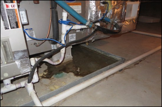

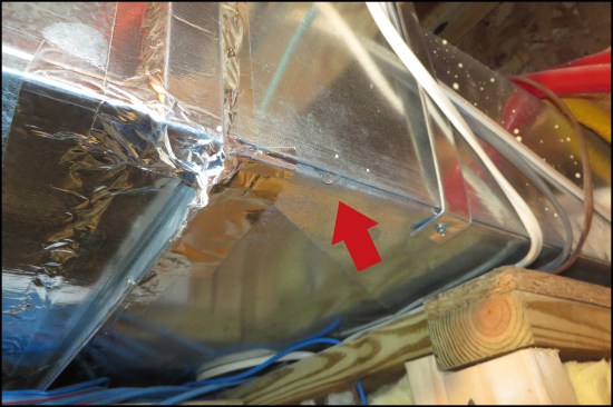

Steam humidifiers put out a tremendous amount of moisture, and if the HVAC fan doesn’t circulate it throughout the house, it will turn into water in the ductwork and leak …
… as seen in the two photos above. The author’s company now uses a secondary safety device to ensure the fan is operating before the humidifier will run.
