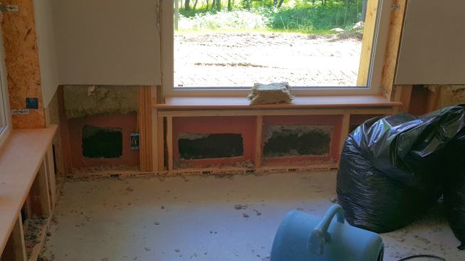

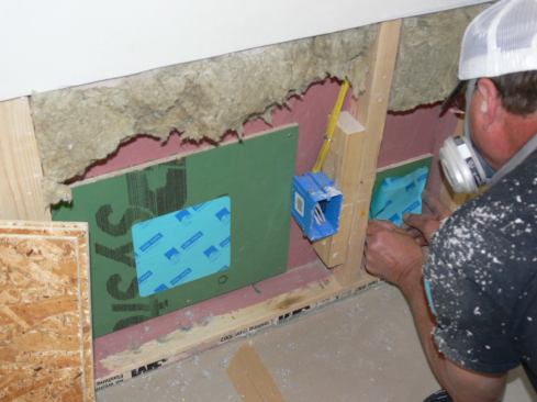

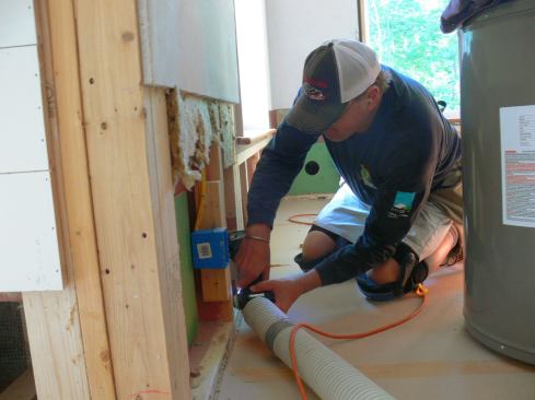

The overnight plumbing break flooded the newly built Passive House with more than a foot of water, some of which was able to seep into the outer insulated cavity of EcoCor's double wall system. Here, a worker pulls damp insulation out of the outer wall from inside the house.

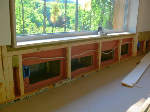

EcoCor’s wall system is an advanced assembly with an inner wall of 2×4 stud framing and an outer wall cavity framed up using wood I-joists screwed to the sheathing of the 2×4 core. The inner 2×4 wall sheathing forms the air barrier for the house. In recent years, Corson has developed a system for panelizing these superinsulated walls in a factory space in Searsmont, Maine. JLC covered the method in 2014 (see: “Panelizing Passive House,” Coastal Connection 6/1014).

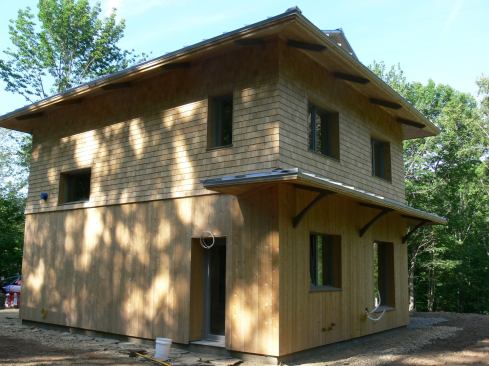

Last winter, Corson says, he set one of his panelized packages in Camden, Maine. “They came to us with a Hawaiian and Japanese-inspired design concept,” Corson says, “and we turned it into something that could be built within their budget. We did our Passive House panel thing, and stood the package, and then they took over to install the ventilation system (under our guidance), and they did all the interior finish work. It’s a cute little house — about 1200 square feet — with cedar siding, cedar shakes, and a metal roof.”

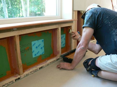

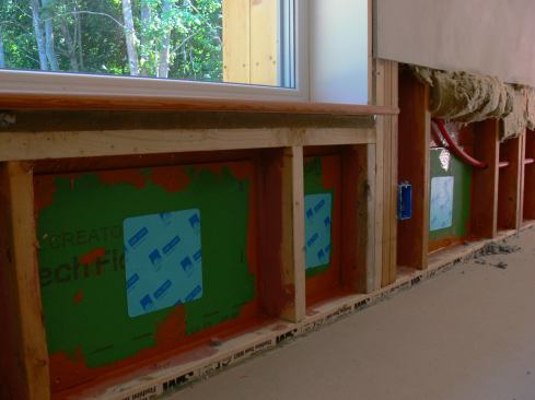

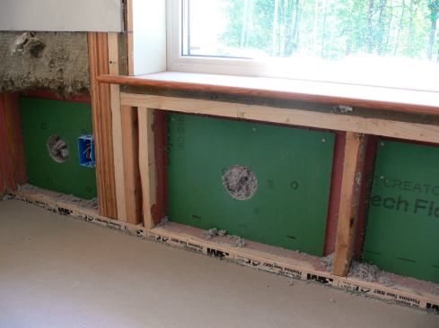

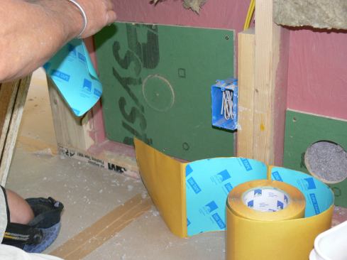

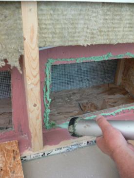

Corson had heard stories of other builders failing the tough spec because of air infiltration through the face of OSB sheathing. So he experimented by taping clear plastic over some of his exposed OSB walls with the blower door running. Sure enough, he says, the plastic “pooched out.” His solution was to coat the inside face of the OSB with a fluid-applied air barrier membrane from Prosoco. “As soon as we did that,” he says, “we blew about 0.28 ACH50.”
That lesson was learned, says Corson: from then on, he switched from regular OSB to ZIP System sheathing for his Passive House panels. “It’s about $600 more per house,” he says, “and it makes a perfect air barrier. It’s a no-brainer.”

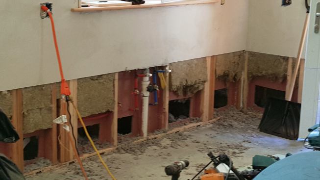

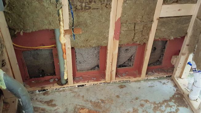

Fast forward to June of this year. The new homeowners are almost ready to move in. They’re in the house working on the trim. They finish for the day and go home. When they come back the next morning, they can’t open the door — because there’s two feet of water pushing against it. A pipe fitting on the main water line (supplied by the city) has broken, and the house is flooded. Not a drop has leaked out. “All their tools were floating around in there,” says Corson. “It was like an aquarium.”

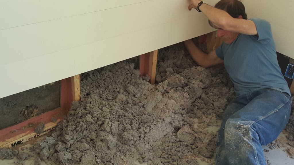

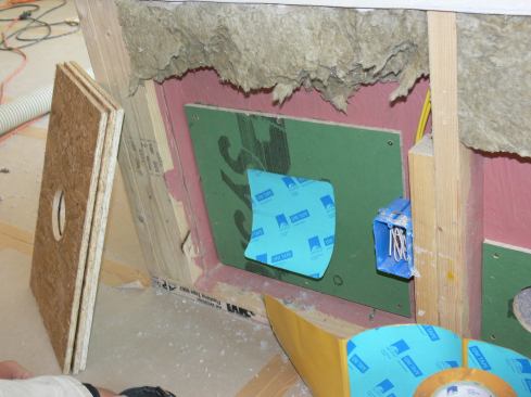

Ironically, says Corson, the fluid-applied flashing he put on the walls in mid-construction — which were never part of the plan before the blower door test results were too high — may have saved the house. Corson pulled his crew off other projects for a rush job to repair the water damage. “We had to tear off some sheet rock, pull the wet insulation out, dry everything out, blow in new insulation, and patch the holes back up and re sheet-rock it,” he says. “But without that wet flashing, the water could have wicked up the OSB and ruined the whole first floor. The wet flash literally saved the house.”
The house was built on a slab foundation, with polished concrete for the finish floor. “So there was no wood flooring to ruin,” says Corson. “Basically they lost some tools and we had to fix some walls. It was maybe a $10,000 insurance claim, that’s it.”
