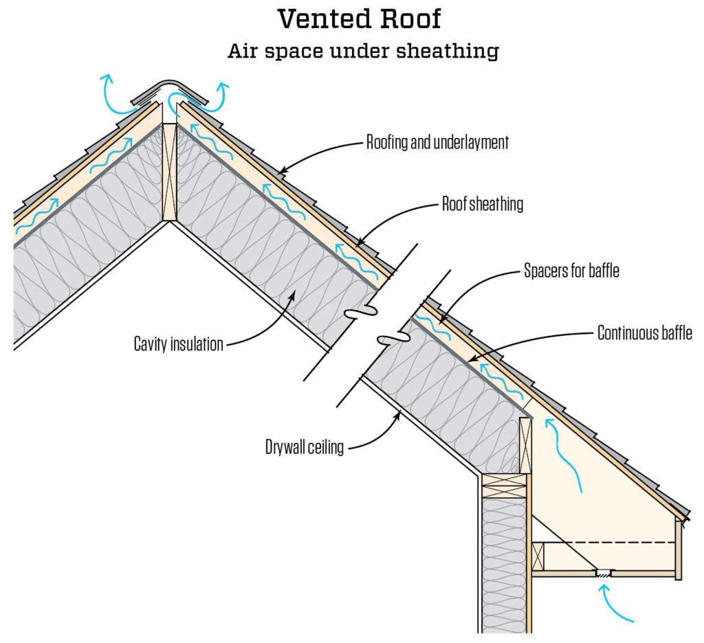

Vented roofs work in all climate zones, but depend on a few critical details: 1) Both soffit and ridge vents in each rafter bay. Balanced openings work, but it’s better if the soffit inlets are larger than the outlet at the ridge to positively pressurize the vent space. 2) A perfect air barrier, either at the ceiling or at the baffle. Avoid can lights, but if you must use them, make the baffle the air barrier. 3) A continuous baffle to prevent ventilation air from washing over and passing through fibrous cavity insulation. The challenge with a vented cathedral ceiling assembly is getting enough insulation into the limited space of a rafter cavity to meet energy code minimums. Consider either using deeper rafters (using I-joists or parallel-chord trusses) or adding a layer of rigid foam to the underside of the rafters and strapping the ceiling for drywall. The rigid-foam option has the advantage of providing a thermal break.
In a vented cathedral ceiling, a vent channel runs from soffit to ridge under the roof sheathing and above the insulation. This venting is supposed to deal with several problems caused by excess heat or moisture: Heat escaping through an under-insulated assembly can melt snow on the roof, causing ice dams. Venting above the insulation helps keep the roof deck cool. And if humid indoor air leaks though the ceiling, roof vents are supposed to whisk it away before it can condense on a cold surface.
However, ventilating above fibrous insulation comes with an energy penalty. Fibrous insulation is designed to be enclosed in an airtight cavity. When air flows over and through it, the insulation suffers a substantial loss of thermal performance. Best practice calls for installing a continuous insulation baffle from soffit to ridge to isolate fibrous insulation from the vent channel.
Warm climates are a bit more forgiving to cathedral ceilings. The venting can introduce humid air into the assembly, which could be drawn toward cool interior surfaces and then condense. Throughout the southeast, there are plenty of examples of "sweating ceilings" and the resulting mold growth to show the inadequacies of a vented assembly. But these sorts of problems are more common to attic assemblies where the humid outdoor air often encounters cooling ducts and air handlers located in the attic.
In theory, a vented assembly can work in any climate, but it has real limitations for a cathedral ceiling. For starters, high-density 10 1/4-inch batts will give you R-38 in a 2x12 assembly, so they'll work up to climate zone 5 under the 2009 IRC, and up to climate zone 3 under the 2012 IRC. In colder climate zones, however, you'll have to bump up to deeper rafters, using blown-in insulation with I-joist rafters (see "Framing a Roof With I-Joists," Jun/13) or parallel chord trusses. Or you can add a layer of rigid foam to the underside of the ceiling joists and strap the ceiling drywall. This latter option works well to reduce thermal bridging through the rafters, which takes care of a variety of misfortunes, including condensation on rafters due to thermal bridging, particularly for an imperfect batt insulation job.
Perfect air barrier. Assuming that you have enough insulation in the ceiling, the next hurdle to overcome with a vented assembly is installing a near-perfect air barrier. This can be at the ceiling plane or at the insulation baffle. If air sealing at the baffle, use rigid insulation as the baffle. Mount the panels between the rafters on strips of rigid foam glued with adhesive to the sheathing, tape between panel sections, and foam seal at the edges, paying particular attention to the seal at the eaves blocking and at the ridge. Without an effective air barrier, the air flow in the vent channel from soffit to ridge will create negative pressure, drawing moist indoor air through any leak in the ceiling and pulling that air through the fibrous insulation where it can condense on the underside of the sheathing

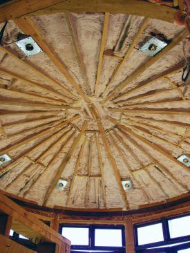

Types of spray foam. There are two basic kinds of spray foam: open-cell foam and closed-cell foam.

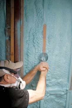

Open-cell spray foam is a good air barrier, but it's not a vapor retarder. In cold-climate homes with high indoor humidity, problems with the use of open-cell foam have been well documented (see "Repairing a Rotting Roof," Jun/10). Open-cell foam can be used for an unvented roof assembly in cold climates, but you'll need to install a secondary vapor retarder to meet code in climate zone 5 or higher. In addition, every effort should be made to lower indoor humidity using mechanical ventilation. Some builders also suggest installing the roofing on battens to help dry the sheathing if it does get wet. But the least risky and least labor-intensive option for cold climates is to stick with closed-cell spray foam.
Closed-cell foam is denser than open-cell material and often dries stiff, making it difficult to clean off the face of the framing when it has to be sprayed to full depth in a framing bay.
Closed-cell spray polyurethane foam (also known as "two-pound foam") has an R-value ranging from R-5.8 to about R-6.8 per inch. The variation largely depends on how the foam is mixed on site, and there can be problems if the installer is inexperienced. (For more information about SPF variations, see: "Troubleshooting Spray Foam Insulation," Sep/10.)
Open-cell foam (or "half-pound foam") has an R-value of 3.5 to 3.8 per inch. Advocates of open-cell foam (mostly in moderate climates) like the fact that it has a drying potential that is much like wood's, making for an assembly that will dry faster if it becomes wet from a leak. Open-cell foam expands much more than closed-cell foam, which makes it quicker to install to full cavity depth.
Closed-cell foam only expands from 30 to 50 times its liquid volume, making it easy to control when installing in shallow or oddly shaped cavities—for example, in a complex vaulted ceiling that couldn't be insulated with anything but spray foam. The low expansion also makes it easy to install without completely filling the framing bay. With an installed cost upward of $1 per board foot, this is increasingly how it's done: Fill the cavity enough to satisfy the minimum requirements of Table R806.5, then blow the remainder of the cavity with cellulose or fiberglass, or install batt insulation to reach the overall insulation requirement. In an unvented assembly, the insulation must be placed against the bottom of the sheathing (no air space).
In cold climates, pay attention to thermal bridging. Do not partially fill the cavity with spray foam and leave an air space between the foam and the back of the finish ceiling. Thermal bridging through the joists creates a cold surface at the edges of the joist bay. A thermal cycle between these cold surfaces and the warmer space between the joists can reportedly siphon away heat. If you can satisfy the entire insulation requirement with just a partially filled cavity and don't have the budget to fill the rest of the void with insulation, be sure to hit the side of the joists with spray foam so that the cold rafter is isolated from the air space behind the ceiling.

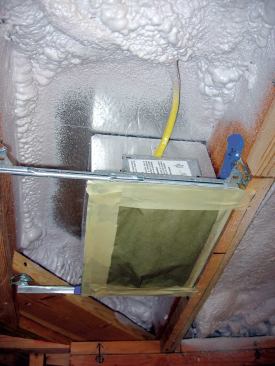

Dealing with can lights. If you have the option, avoid recessed lighting in a cathedral ceiling insulated with spray foam. Even without the ventilation air flow to exacerbate air leaks, you'll end up with an insulation dead space. The other issue is clearance. Even if the fixture is IC-rated (for insulation contact), you can't embed it in foam. You need to provide enough clearance from the insulation so that the fixture doesn't overheat and pop the thermocouple.
When recessed lighting is unavoidable, best practice calls for installing a piece of foil-faced rigid foam above the fixture, or isolating the fixture from the insulation by installing it in a metal box. Before spraying foam, mask the fixture to keep it clean and lap the spray foam onto the rigid board to create an airtight seal. If the rigid foam butts framing, caulk that joint using a polyurethane sealant. (It will also help to advise the homeowner to use only CFL or LED lights, to avoid heat build-up.)

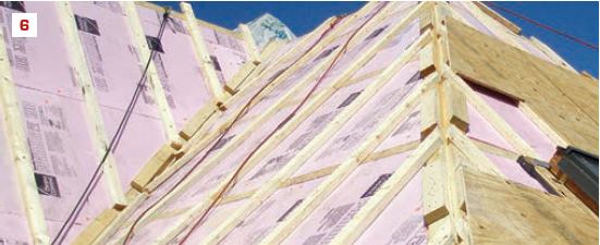

Air-impermeable insulation can also be added above the roof deck using rigid foam board. As with spray foam, you need to add enough R-value to protect against condensation, and it needs to be located directly above the roof sheathing with no air space (though it is common to install an underlayment such as roofing felt or a synthetic membrane to protect the building until the roof is dried in). You can, of course, add much more rigid foam than the minimum needed to satisfy the code requirements. While you can add roof venting to an assembly insulated with spray foam for an extra margin of safety you can't add ventilation below the roof deck with rigid insulation installed above it. If you want to vent the roofing, though, you can add an air space above the rigid insulation. At the eaves, a nailer applied to the roof deck will simplify the drip-edge installation.
Filling the void. Below the foam, the cavity can be filled with blown fiberglass or cellulose, or with any batt insulation. The shortcoming with batts is the frequency of installation error. Voids and compressions are more common than most of us want to admit. In new construction, blowing the cavity is more commonly done through netting or reinforced poly, mostly because the insulation will need to be inspected before drywall. Installing the netting or poly usually takes twice as long as actually blowing the cavities.
To control condensation, you can also insulate from above using rigid foam board. The advantage of this method is that you reduce thermal bridging by isolating the roof structure from the exterior. As when insulating below the deck, an adequate amount of insulation must be next to the sheathing. This means no air space; a layer of roofing underlayment can still be installed over the sheathing before the insulation to protect the building from rain until the roof gets dried in.
As described in "Best Practices: Continuous Exterior Insulation" (Nov/13) rigid foam options include faced polyisocyanurate at about R-6.5 per inch, extruded polystyrene (XPS) at about R-5 per inch, or expanded polystyrene (bead board) at about R-4 per inch.
The foam boards must be installed at a thickness to meet the minimum R-value of Table R805.6. (For example, to meet the R-25 requirement for climate zone 6, install 4 inches of foil-faced polyiso.) This, of course, is a minimum and much more insulation can be installed. Building Science Corp. (BSC), for example, regularly describes an R-40 roof assembly using 6 inches of polyiso board—installed in two 3-inch layers or three 2-inch layers—with the vertical and horizontal joints between panels staggered. David Joyce, of Synergy Companies Construction, in Lancaster, Mass., has installed this assembly a number of times for BSC (see one example in "Retrofitting Exterior Insulation," Nov/09). His crew tapes the seams between insulation panels, then secures the panels through a layer of 5/8-inch plywood sheathing with 10-inch FastenMaster HeadLok screws driven into the rafters.
