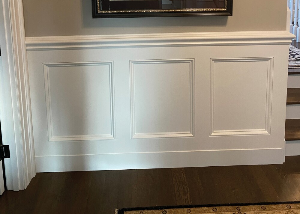

White paint finishes a traditional raised-panel wainscoting. This look is what most people think of as wainscoting but is nowhere near the only option for clients.

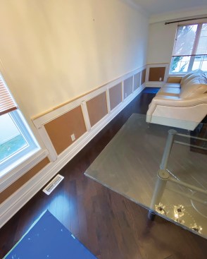

On a raised-panel style of wainscoting, rails form boxes, and profiled trim tops hardboard panels.
Using the level line from the laser, I mark the walls in a few places so that when I put up the chair rail, it is straight across the whole room. This is important because that line will be about eye level for anyone sitting in the room and any wave will stand out. At this time, I also mark where the studs are along the wall.

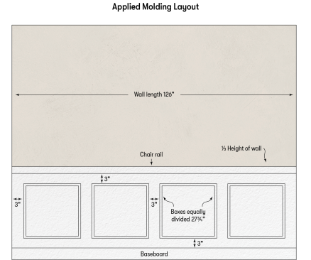

Next, I measure up the walls to lay out the panels, or boxes, starting with the longest wall. For the applied molding shown in the illustration below, I measure the total length of the wall and then subtract 6 inches to allow for a 3-inch space (can be blank wall or a rail) out from the corners; I’ll also allow 3 inches up from the baseboard and down from the chair rail.
A few factors help me decide on the number of boxes for any given space. I don’t want the boxes to be too narrow, as that gets busy visually and makes it difficult to avoid outlets. Large boxes can work, but the look will differ from what most people picture as wainscoting.
Let’s say the wall is 126 inches long, and I subtract 6 inches for spacing from each corner. With 120 inches left, four or five boxes will divide the space well. Before I start putting more lines on the walls, I usually draw the layout on paper so I don’t miss anything. If I go with four boxes, I need to account for the three spaces between them:
120 inches – (3 x 3 inches) = 111 inches.
To find the width of each box, I divide 111 by 4, which equals 27¾ inches. The center of the space between the two middle boxes will be in the center of the wall. If I go with five boxes, each box will be 215/8 inches wide and the middle box will be centered on the wall.
The illustration shows a simple wall layout for applied molding. This same layout could be used with raised panels with added layers of trim elements.

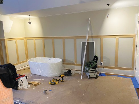

Applied molding can look complicated, especially with a high-contrast palette, but most of the layout here was created using a 3-inch block along the chair rail, baseboard, and ceiling. Then we filled in the vertical lines at the desired spacing.
With my layout chosen, I draw the final layout lines on the wall while my partner batch-cuts the moldings. As the boxes are the same size for each section, stops can be set on the miter saw to speed up production. I found that having one person cut and the other person lay out and install was efficient and maintained consistency.
Installation
Installation for the project shown above begins with the chair rail and, in the projects pictured below, it starts with the top rail; in all cases, apply a bead of adhesive on the back of the rail, hold it on the level lines, and nail at the stud markings. For adhesive, ordinary latex caulking is sufficient and cost effective. Whether you use caulking or a heavy-duty construction adhesive, the bond is going to be able to pull the paper off the drywall. I’d rather not spend more on unnecessary strength while inviting a more challenging cleanup of any squeeze-out. With the boxes or panels, you won’t hit studs for much of the installation, so the adhesive is important.

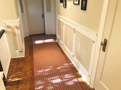

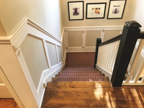

Stairways

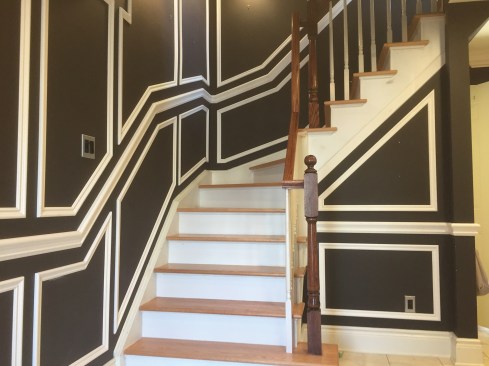

A room or a hallway is a straightforward project, while stairways involve a bit more planning. Curved walls, elevation changes, and the like add to complexity but also have a much larger impact visually. The layout basics remain the same, with setting the chair rail to start and then working out the panel spacing and sizes, but some of the methods are different.
This type of material provides the look of a raised panel but is faster than installing a secondary molding inside each of the “panel” spaces.
For chair rail height, I use a story pole with the desired height marked on it to transfer marks to the wall. That height may be different from the other horizontal runs to allow for handrail mounts to land centered on a stile or rail or within a panel. Holding the stick plumb with a level, I make a series of marks that represent the top edge of the chair rail. Each mark consists of a vertical plumb line and a line at the desired height.
Another method is to put masking tape on a level and mark that at the length you want to set your marks. In either case, the vertical height is measured from the top of the exposed stringer or, if that is not present, off the nosing of the stair treads. The marks are then connected with a straightedge or, if the wall is curved, used as reference points that the molding needs to touch as you install the chair rail.
Determining box size uses the same method of measuring length and dividing as discussed earlier. Taking measurements can be tricky on curved walls and usually needs two people to keep the tape on the walls. With stairs, we took extra time to draw out the boxes. Often, we used masking tape to represent what the finished product would look like and to confirm the layout with the homeowner or designer. As an added benefit, it helped us double-check our calculations.

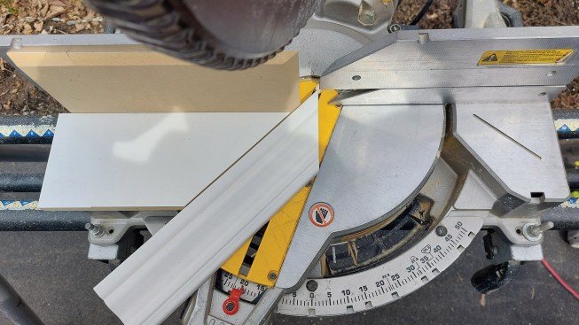

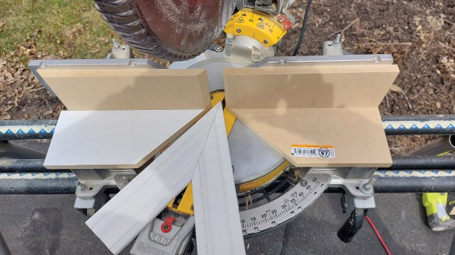

Many of the angles will be greater than what most miter saws can cut normally. In photos below, I’m using a jig mounted to the saw to create these sharper angles. The jig is at 45 degrees, but by holding the molding to it and adjusting the miter angle on the saw, I can cut angles greater than 45. Let’s say the miter needed is 65 degrees. Subtracting 45 (the set angle of the jig) from 65, we get 20. Set the saw to a 20-degree miter while holding the molding tight to the jig, and you are left with a 65-degree cut. There are commercially available versions of this setup, but I just use my own.
A site-built jig to cut angles above 45 degrees is affixed to the saw fence.
Cutting a 45 on the end of the board first makes getting sharper miters easier.
For installation of moldings on stairways, as with any room, careful nailing to framing where possible and the use of adhesive are important. Issues with stairs include handrails and light switches. While running lines for the chair rail or panels, be prepared to adjust heights or sizes to avoid running into those features.
