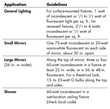

Lighting is critical in bathrooms — both general lighting and task lighting. General recommendations are presented in Figure B.

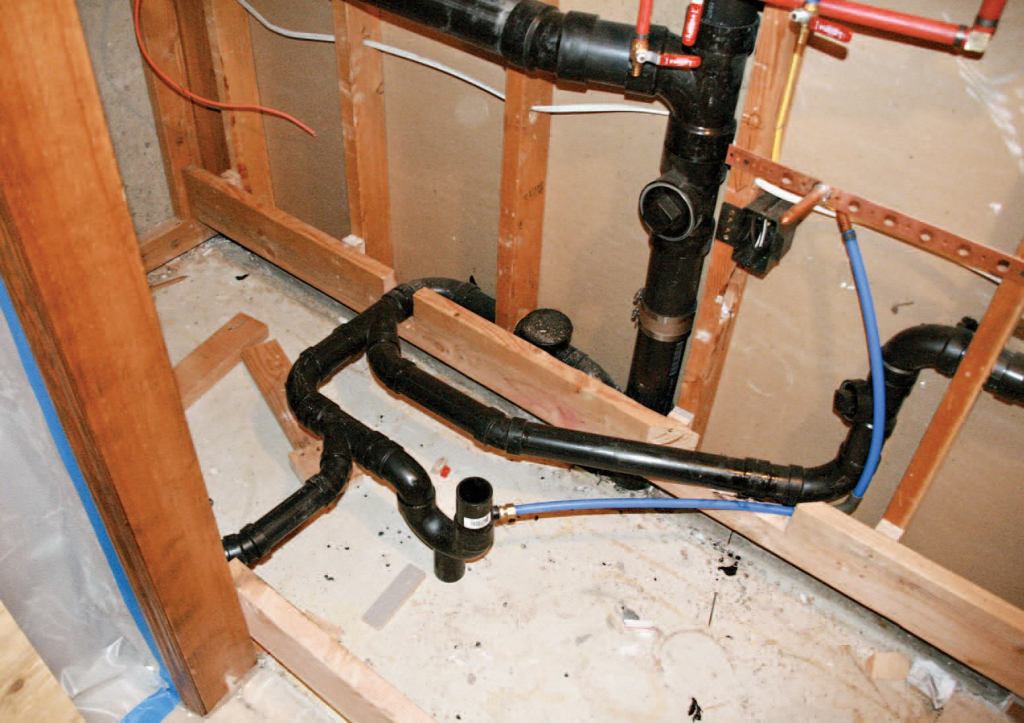

Small baths with utilities. To reduce plumbing costs and save space, the core plumbing and heating utilities, as well as the washer and dryer, often are included near the bathroom. Two layouts are shown in Figure G.
Duplex townhouses or other narrow lot designs often require a narrow room layout. Figure H shows one solution for incorporating two baths and a utility room, keeping all the plumbing tightly arranged.

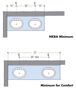

Double lavatory. Provide a minimum of 30 in. (36 in. recommended) between multiple lavatories, measured centerline to centerline. If space allows, a wider separation between lavs will be much more comfortable for users (Figure K).
For baseline, minimum access, locate the centerline of a lav at least 15 in. from a side wall and space double lavs a minimum of 30 in. from center to center. For more comfortable use, allow at least 3 ft. of wall space per user and 42 in. for a single vanity width.
