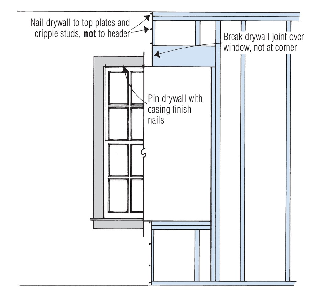

Minimizing cracks at openings. To prevent cracked drywall joints at the corners of windows and doors, place the sheet so the joint falls in the center of the opening, and then cut out the waste. Do not fasten the drywall to the header; use the interior casing to secure the loose edge of the drywall at that location.
