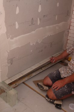

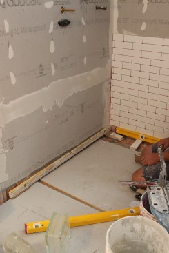

The crew member sets the bottom course for the adjacent wall by placing a level under the bottom tile on the first wall. The level will act as a ledger for the bottom tile course.

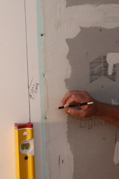

The shower is to receive a glass-block wall, so here the crew member draws a plumb line at the location of the wall.
Using the story board, he determines that he can begin the tile installation in the corner with a full tile.
