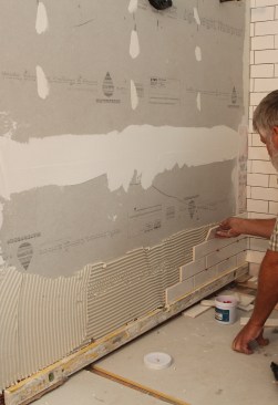

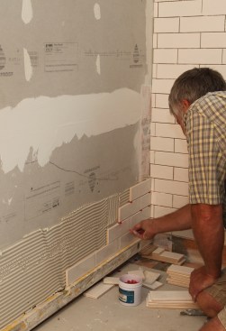

For this wall, the crew member begins the installation in the corner, alternating full and half tiles to establish the stair-step pattern. Again, he uses plastic wedges to set the width of the horizontal grout lines.
He builds the first four courses and then finishes them across the wall.

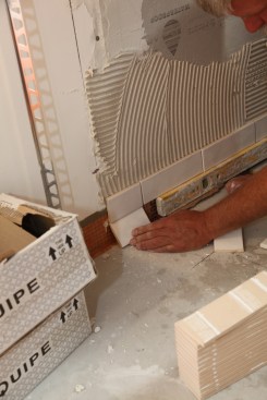

He supports the end tile with a scrap to hold it level.
