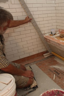

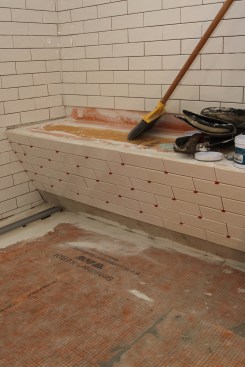

The courses for the angled face of the shower seat won’t match up evenly with the adjacent wall. The crew member uses the story board to set the ledger giving him a full course under the shower seat.
He finishes the shower seat face, leaving the bottom courses out until the floor tile is done.
Continuing the Adjacent Wall Installation
