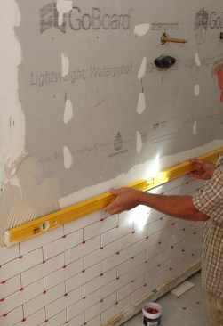

After completing a few courses, the crew member checks the courses to make sure they are straight and level.

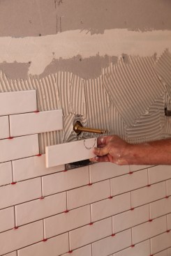

For the shower faucet stubs, he traces the cut out onto a tile.

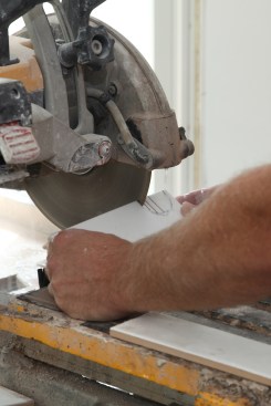

He uses a wet saw to make the odd-shaped cut out. After cutting out for the faucets, he completes the tile up the wall.

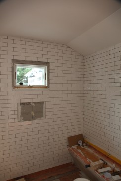

The opposite adjacent wall is completed in similar fashion, with the tile running up from the top of the shower seat.
Metal Edging to Complete the Shower Wall
