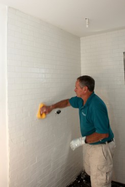

First Wipe Down
After striking the horizontal joints, the author gives the wall an initial wipe down with a sponge and clean water. He stops regularly during the process to rinse the sponge, working his way methodically over the entire surface of the wall.
