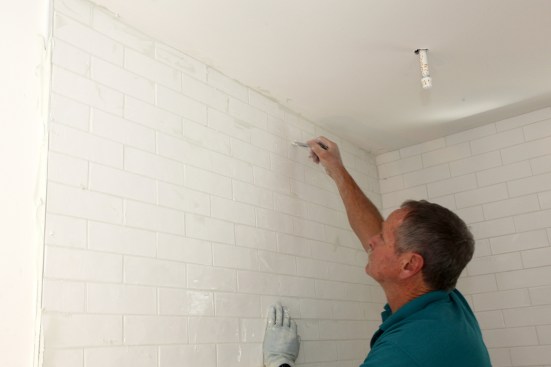

Striking the Horizontal Joints
The author uses the rounded plastic end of a marker pen to strike the horizontal tile joints. The tip of the pen is the right diameter to leave a neat, even, and well-packed grout joint, with the pen keeping all the horizontal joints perfectly consistent.
