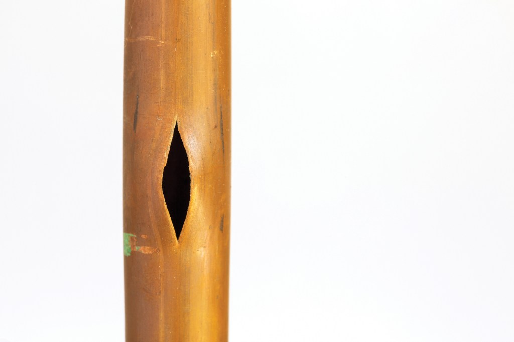

Burst copper water pipe due to frost
Stephen Cordory/Adobe Stock Image

Water expands when it freezes, increasing in volume about 9% from its liquid state. That’s why ice floats—it’s less dense than liquid water. This increase in volume is the proximal cause of ruptured water pipes when they freeze but probably not for the reason you think. Expanding ice doesn’t push against the pipe walls to cause the rupture; instead, it’s high-pressure liquid water that does the damage.
Pipes that freeze are cooled from the outside in. The warmest location is always the liquid in the center of the pipe. As temperatures drop below freezing, the water starts freezing on the inner surface of the pipe in a slow process that allows plenty of time for liquid water molecules to get out of the way as their neighboring, recently frozen, solid molecules rearrange themselves into that 9% larger arrangement. This freezing progresses from the area near the pipe wall toward the center of the pipe—the opposite of tree ring growth but similar to plaque building up in our arteries.
If there are nearby nonfrozen areas, the last drops of liquid in the center are pushed to liquid areas on either side of the frozen area. When the pipe is frozen through and through, the pressure on the pipe walls exactly matches the pressure of the surrounding liquid outside the frozen zone. The water that is finally pushed out of the middle goes toward either the water source (like the water main in the street or the hot-water heater) or the plumbing fixtures at the end of the line (like a sink or toilet).
The relocated water that goes toward the source doesn’t cause much trouble. Usually there are plenty of places to relieve that pressure—a huge volume of water in a municipal system, a hot-water tank, or a well-system storage tank, for example. It’s the relocated water that is pushed toward the end of the line that causes problems, and here is where bursts happen.
In a hot-water line, that relocated water has no place to go. At the end of every line is a valve, and—assuming you’re not running the tap continuously—those valves are shut. Basically, as ice freezes in hot-water pipes, it pushes liquid water up against a dead end.

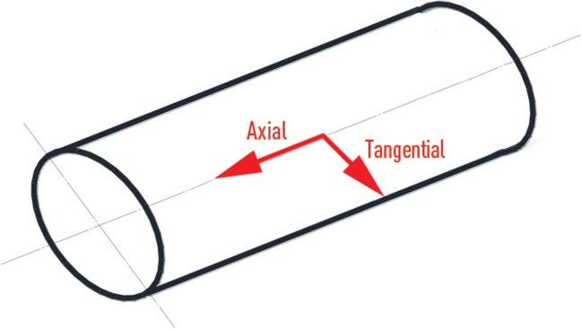

Tangential stress caused by internal pressure in a water pipe acts perpendicular to axial stress and tends to separate a pipe wall in a line parallel to the pipe’s center line.
Water pipes burst in the same way as overcooked sausage—always along their length, not at their ends. Like the filling inside a sausage skin, water inside a copper pipe can cause only two stresses on the enclosure material: axial (which tends to change the length of a body) and tangential (where the direction of the deforming force is parallel to the cross-sectional area).
When you work through the math, you find that the axial stress is always half the tangential stress for any given internal fluid pressure. So, the sausage and the water pipe always burst along their length because that’s where the greater stress exists.
