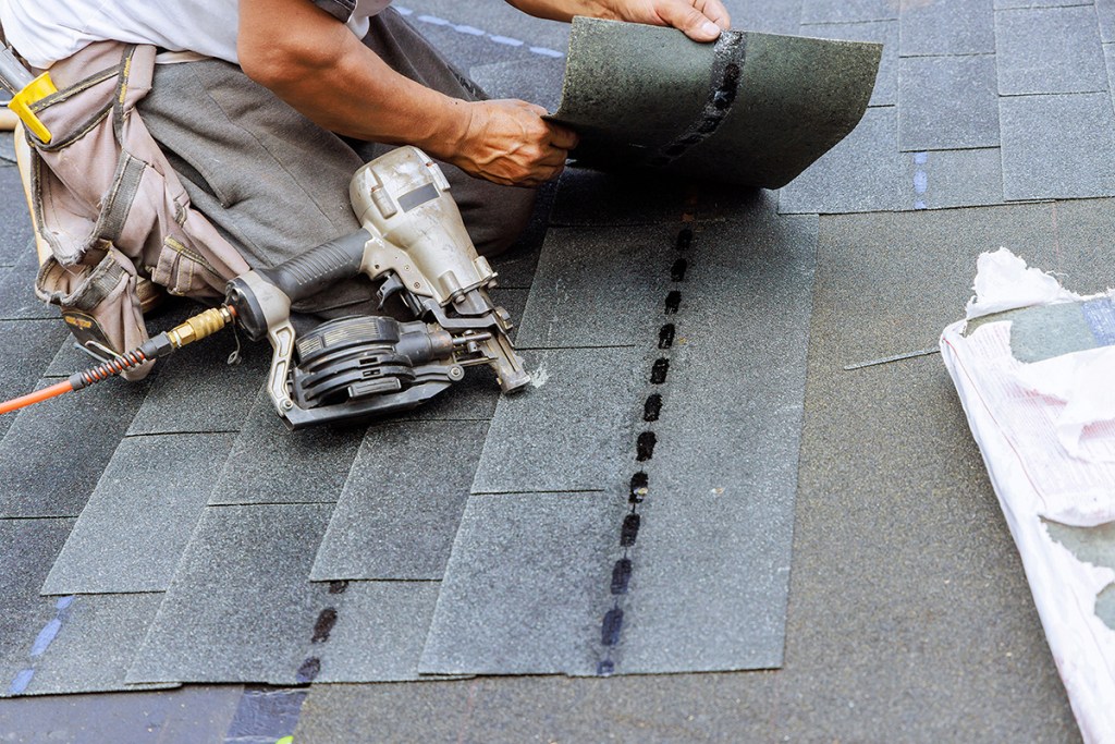

Roofer uses an air pneumatic nail gun to attach new asphalt bitumen shingles to roof
Q: One of my fellow workers insists that the cellophane strips on the backs of asphalt shingles have to be removed before the shingles are installed. Another co-worker says that it’s OK to leave them in place. Which one is right?
