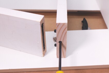

For cabinetmakers who need a knock-down assembly, the Clamex is a clamped, two-part mechanical joint that’s assembled and disassembled with a small Allen key. It comes in different sizes for different applications.
Available in a couple of sizes, the Clamex connector has a lever that is operated with a hex key, which allows the joint to be disassembled if desired.
Access for the hex key to the lever mechanism that engages the Clamex connector is through a small, 6-mm hole.
